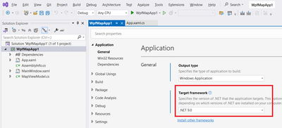

After creating project, you can find .NET version in project properties:

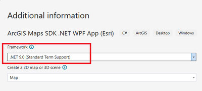

You can select .NET version in next step after choosing project template, selecting location for project:
