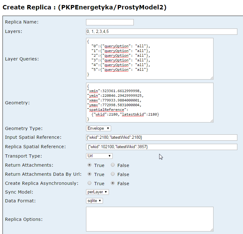

I created replica using queryOption: all to make sure that I download all features.
