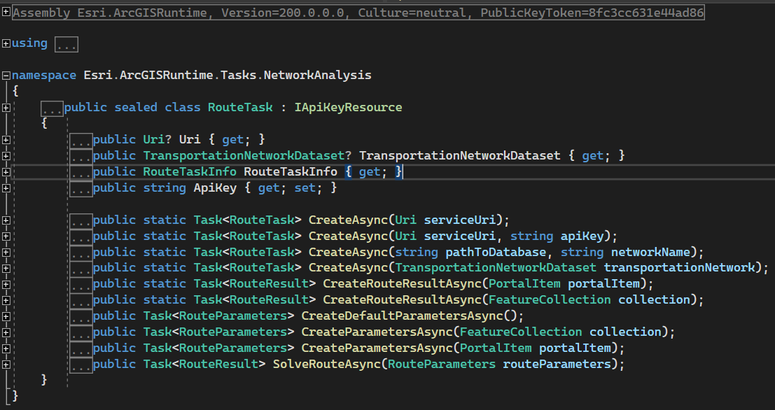

Hello,
We have an .NET Framework application that uses the ArcGIS Maps SDK for .NET version 200.0.  The app includes functionality for routing/navigation.
We would like for the user to be able to cancel the route calculation (for example, if it's taking too long, etc).  In the tasked-based async pattern in .NET (which we are using in our app), the recommendation is to support a CancellationToken parameter on asynchronous methods so that long running tasks can be cancelled if necessary.
Would it be possible to add the CancellationToken parameter to the RouteTask methods in a future release of the ArcGIS Maps SDK?
Do you have any recommendations on how best to handle cancellation in the meantime?  I was thinking of either letting the route solve continue to completion and then throwing away the result, or perhaps running the route solve in a separate thread and stopping that thread upon cancellation (which I'm concerned might lead to resource leaks).
Thank you!
David
dotMorten_esri
Esri Notable Contributor
For now you can just throw away the result. Most of the work is done server-side, and once the request is fired off, you can't really stop the server from doing the processing. You'd only save the download of the response, which is a minimal overhead in the grand total.
