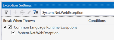

Do you have any details on these exceptions? (if it's not hitting a breakpoint, check these types off in the Exceptions settings window in Visual Studio to force a break on the exception).

Were you able to enable breakpoints in the error list window to force breaking on caught exceptions?

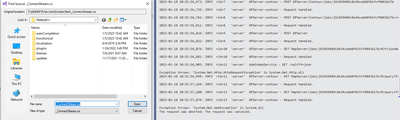

Here is what happens.  Do you need more?   I was running the Simple Contour gpkx in WPF application build for NetFramework 4.8.
I enabled LocalServer debug option also.
When Exception (The request was aborted: The request was cancelled) is triggered, it is looking for _ConnectionStream.cs file.
The call stack:
> System.dll!System.Net.ConnectStream.BeginRead(byte[] buffer, int offset, int size, System.AsyncCallback callback, object state) Line 1667 C#
System.dll!System.IO.Compression.DeflateStream.BeginRead(byte[] array, int offset, int count, System.AsyncCallback asyncCallback, object asyncState) Line 415 C#
System.dll!System.Net.GZipWrapperStream.BeginRead(byte[] buffer, int offset, int size, System.AsyncCallback callback, object state) Line 753 C#
System.dll!System.Net.Cache.ForwardingReadStream.BeginRead(byte[] buffer, int offset, int count, System.AsyncCallback callback, object state) Line 685 C#
System.Net.Http.dll!System.Net.Http.HttpClientHandler.WebExceptionWrapperStream.BeginRead(byte[] buffer, int offset, int count, System.AsyncCallback callback, object state) Line 1313 C#
System.Net.Http.dll!System.Net.Http.StreamToStreamCopy.StartRead() Line 98 C#
System.Net.Http.dll!System.Net.Http.StreamToStreamCopy.BufferReadCallback(System.IAsyncResult ar) Line 167 C#
System.dll!System.Net.LazyAsyncResult.Complete(System.IntPtr userToken) Line 415 C#
System.dll!System.Net.LazyAsyncResult.ProtectedInvokeCallback(object result, System.IntPtr userToken) Line 368 C#
System.dll!System.Net.Cache.ForwardingReadStream.ReadComplete(System.IAsyncResult transportResult) Line 629 C#
mscorlib.dll!System.IO.FileStreamAsyncResult.AsyncFSCallback(uint errorCode, uint numBytes, System.Threading.NativeOverlapped* pOverlapped) Line 366 C#
mscorlib.dll!System.Threading._IOCompletionCallback.PerformIOCompletionCallback(uint errorCode, uint numBytes, System.Threading.NativeOverlapped* pOVERLAP) Line 135 C#
