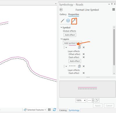

Hi there! I need to offset lines. I have searched and not found any answers. Does anyone have an idea of how to do this in Pro? I was doing it in ArcMap. @KoryKramer ? thank you.
KoryKramer
Esri Esteemed Contributor
Have you tried to add a symbol layer (stroke) and apply an offset effect?
https://pro.arcgis.com/en/pro-app/latest/help/mapping/layer-properties/symbol-effects.htm
That's if you want to show the original geometry as well as the offset stroke.  Otherwise, you could just apply an offset effect on the single stroke symbol.
Does that help?
by Anonymous User
Not applicable
@KoryKramer  that's what I needed! thank you!!
