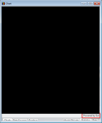

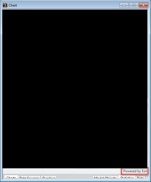

I will see the following:
As you can see, that Powered by Esri get display but the map itself is blank/transparent.

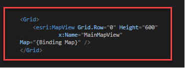

Here is the code for Map control:

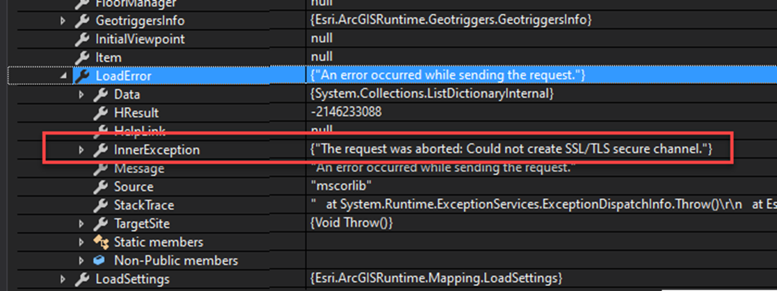

I also see the following in debugger (after Map is created and the view is created) which I will not see in other solution:

Looks like there's an issue with communicating with ArcGIS Online. Are you able to load the basemap in a .NET application, without using MFC? Which version of the API and .NET are you using, and what operating system are you using? If any of those are really old, you might just be using a component that doesn't support TLS1.2+

I'm not sure why your MFC app is running with only TLS1.0 enabled, but if you add this line of code before using the runtime, it should work:
ServicePointManager.SecurityProtocol = SecurityProtocolType.Tls12;

I can load the basemap now.  Thank you!!
