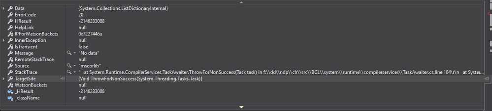

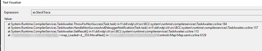

ClayGinn
Nothing specific. There is no inner exception, and the object looks like this:
Exception objectException objectStackTraceStackTrace
