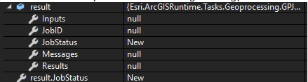

Values returned by result after calling await gp.SubmitJobAsync(parameter):

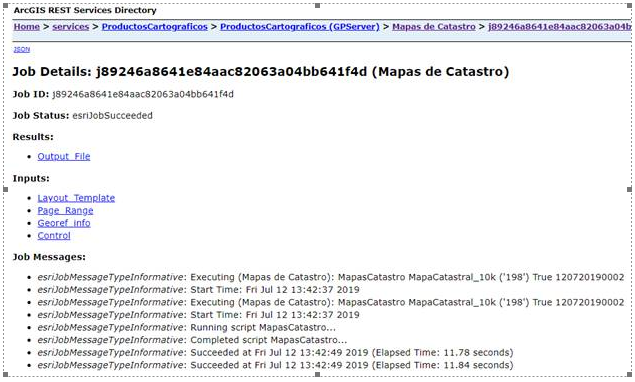

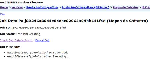

However if I call the geoprocessing task from rest endpoint it works and sends the correct output.

Should I deal with status New and no JobID or any ideas on how do I fix this situation?
