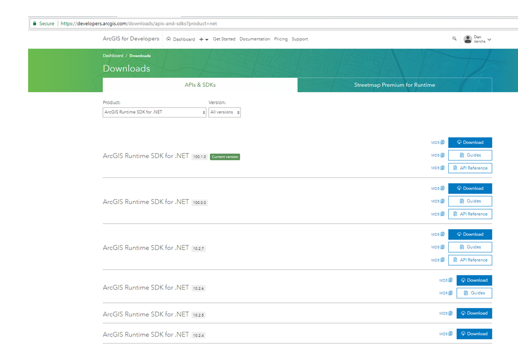

We have tried to use later ESRI Runtime versions like 100.2 but this is incompatible with the Agentry client as it crashes immediately with an error 'System operation failed'.

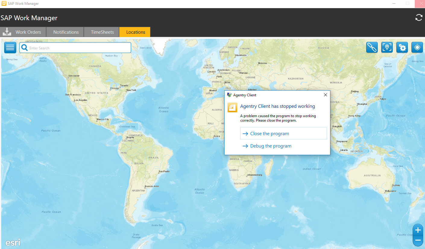

This error was seen in our Windows Agentry client (a frontend client for SAP Work Manager used by field personnel) that has been integrated with ESRI runtime libraries for enabling GIS services.

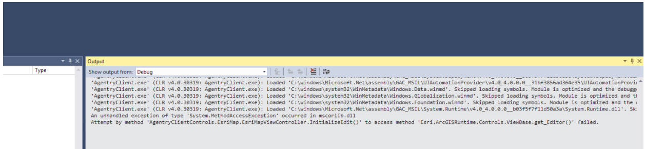

When 'debug the program' option is selected; Microsoft Visual Studio launches with below error:
These ESRI runtime dll files used in our Agentry client folder are delivered on the ESRI website (http://resources.arcgis.com/en/communities/  ) under ArcGIS Runtime SDK for .NET. We are using 10.2.7 as the latest version 100.* is not compatible with our agentry client.

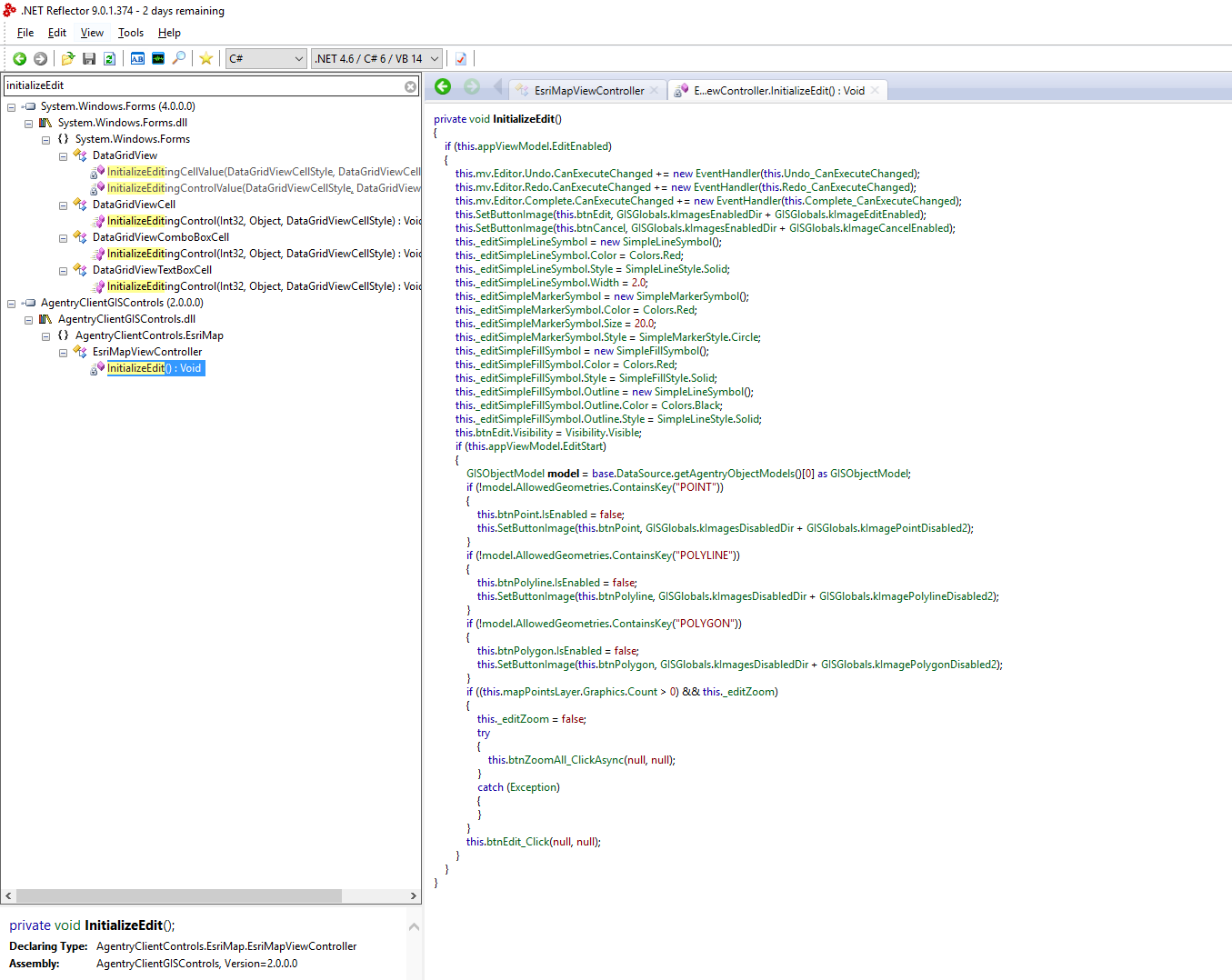

The error that has been reported is thrown from AgentryClientGISControls.dll file --class AgentryClientControls.EsriMapViewController method InitializeEdit(). I am unable to find where in this method the call to get_editor() method is performed.

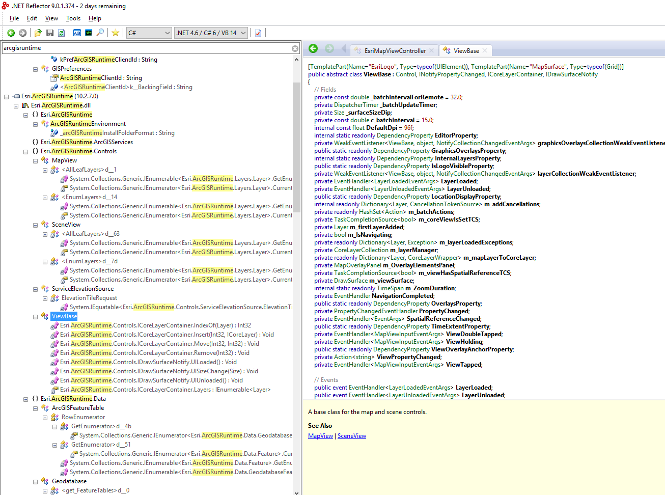

The called method is apparently inside Esri.ArcGISRuntime.dll under Controls.Viewbase. However there is no such method called get_editor() under here.

get_Editor is the property getter method for Editor, which seems to be hit in the very first line of your Initialize code (this.mv.Editor). One thing to consider is that you must be on the MapView's UI thread to access any dependency property, so this might be it.
It could also be related to the security context that your client is running the app in which causes this exception to be thrown. Here's a few resources:

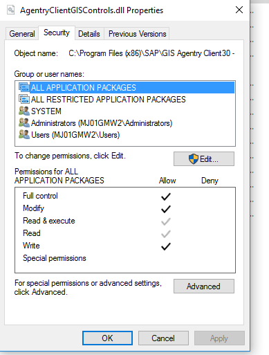

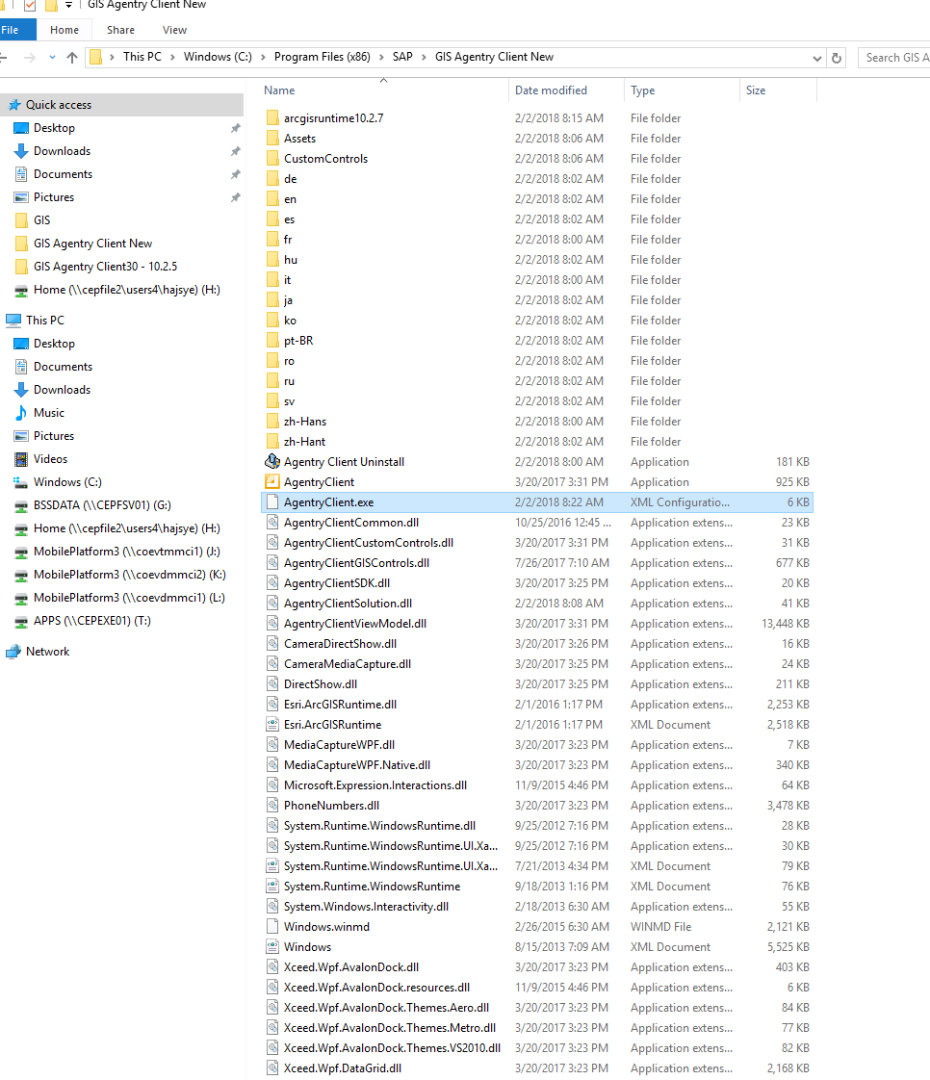

If there is anything to be done with regard to the dll files on the windows side; like trusting them etc; please let me know. I tried to assign full control to the AgentryGISControls.dll and ESRI.ArcGISRuntime.dll by going into their security options; however it made no difference and the same error still appears

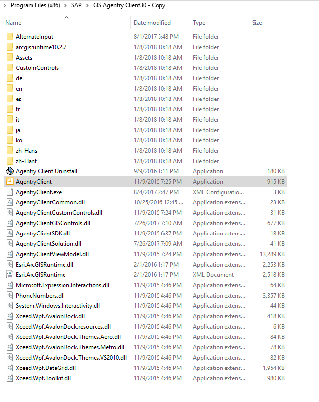

Below is how the files look on our file folder for the Agentry client:
