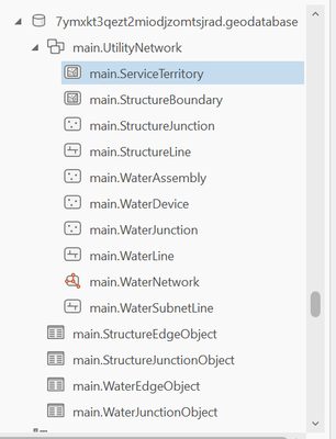

Thank you for the quick reply! Unfortunately, I tried the same workflow but with 200.7 and the issue still persisted with the same errors. I don't know if this helps at all but opening the geodatabase file in Pro, I couldn't find any data related to GpsPoints
Our ArcGIS Enterprise is running 11.4. 11.3 patch https://support.esri.com/en-us/patches-updates/2024/arcgis-server-11-3-offline-utility-network-patch... seems to resolve a bug related to creating replicas. Is that fix included in 11.4 ? Could that be why certain layers aren't included ?
