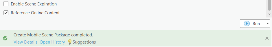

I created TWO version of the file: one WITH end one WITHOUT "Reference online content"

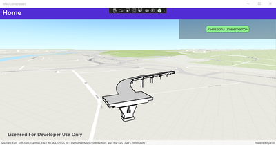

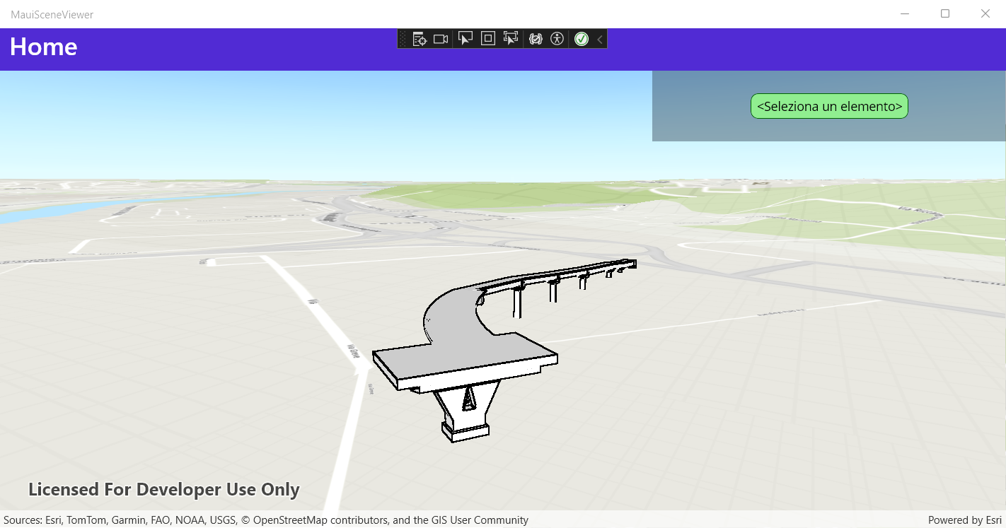

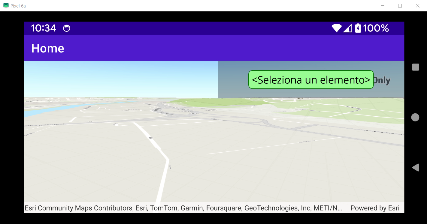

If I use the one WITH BASEMAP get the expected result in Windows BUT NOT in Android (14):
WINDOWS: windows_with_basemap.png
ANDROID 14: android_with_basemap.png

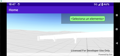

Sometimes, at start, the 3D model appeard but is somehow "wiped out" by the basemap drawing event

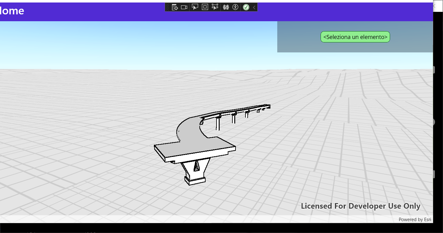

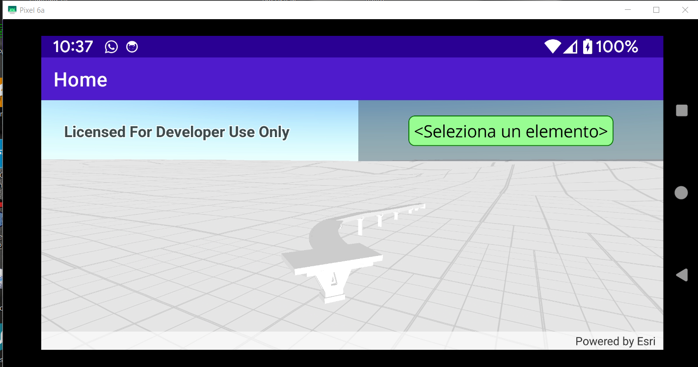

If I use the one WITHOUT I get the expected result both in Android (14) and Windows:
ANDROID: android_no_basemaps.png
All this tells me there is no issue with my data.. ..and it looks like a Runtime BUG.

The proof this is true is the fact that in the 4th picture the 3D model from the local .mspk file is displayed in Android:
The file is accessed and displayed.. ..unless I ALSO enable the Base map!

Sometime, using the .mspk referencing online basemap, it happens that when the scene is rendering, for the first second, second-and-hal, the 3D object is shown.. ..then the "tide" of the basemap-rendering comes.. ..and the 3D object disappears all at once.

ANDROID & Elevation Source & 3D-Model
I have to correct myself: ADDING an ElevationSurface to a Mobile Scene Pakage does NOT prevent a 3D model from being correctly displayed on Android devices.
This is also true if the ArcGISTiledElevationSource is added to Scene ElevationSources programmatically.
The model, if correctly placed in the Z-coordinate, is displayed in both Android and Windows:
Of course, it can also disappear underground if not correctly geolocated using ArcGIS Pro.

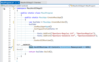

SceneView has a method to override the default memory limit. If you can increase it to 2 or 4GB based on the type of device you have and try to render the mspk, does the model render then? I suspect this because that's the reason why when you have the basemap it uses more memory and thus prevents the layer from rendering.
Please let us know what you find. I hope this helps.
Regards,
Koushik
Marco_Foi
I feel tweaking with memory available to SceneView is possible just in SDK for JS.
I cannot find any reference to this feature in SDK for .NET : can you please check?
Despite this, the issue might be related to a memoy issue indeed!
