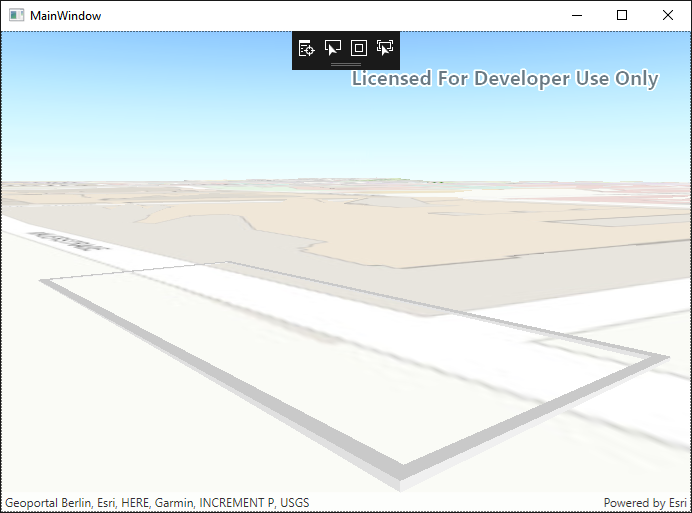

The problem is, that I have no chance to see the data in subsurface. The ground is not transparent, the camera could not be rotated below the surface.
Only the top of the geometry is visible, which is above the ground. (that's the situation the customer will have later, too. The boreholes are filled up with cement and will have an overlap of a few centimeters above surface).

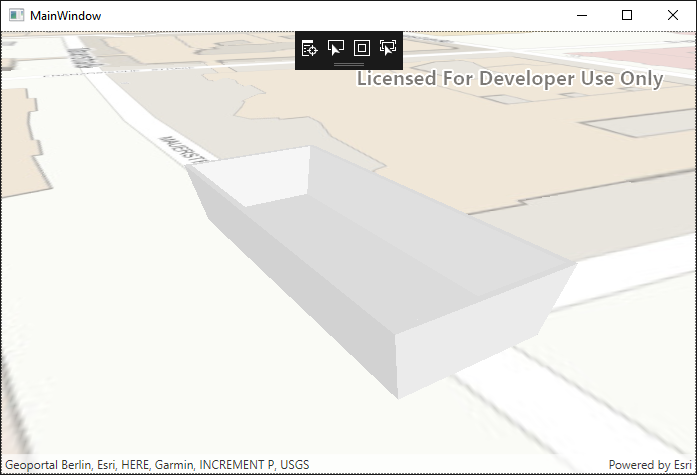

With setting the
sceneSurface.ElevationExaggeration = 0.9;
I could see the full geometry:
But then I will not get a feeling of how deep the geometry is below surface.
