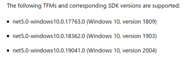

I'm running Microsoft Windows [Version 10.0.19042.746], and on this page it says
So I figured I'd use net5.0-windows10.0.19041.0.
Same results with either one though.
