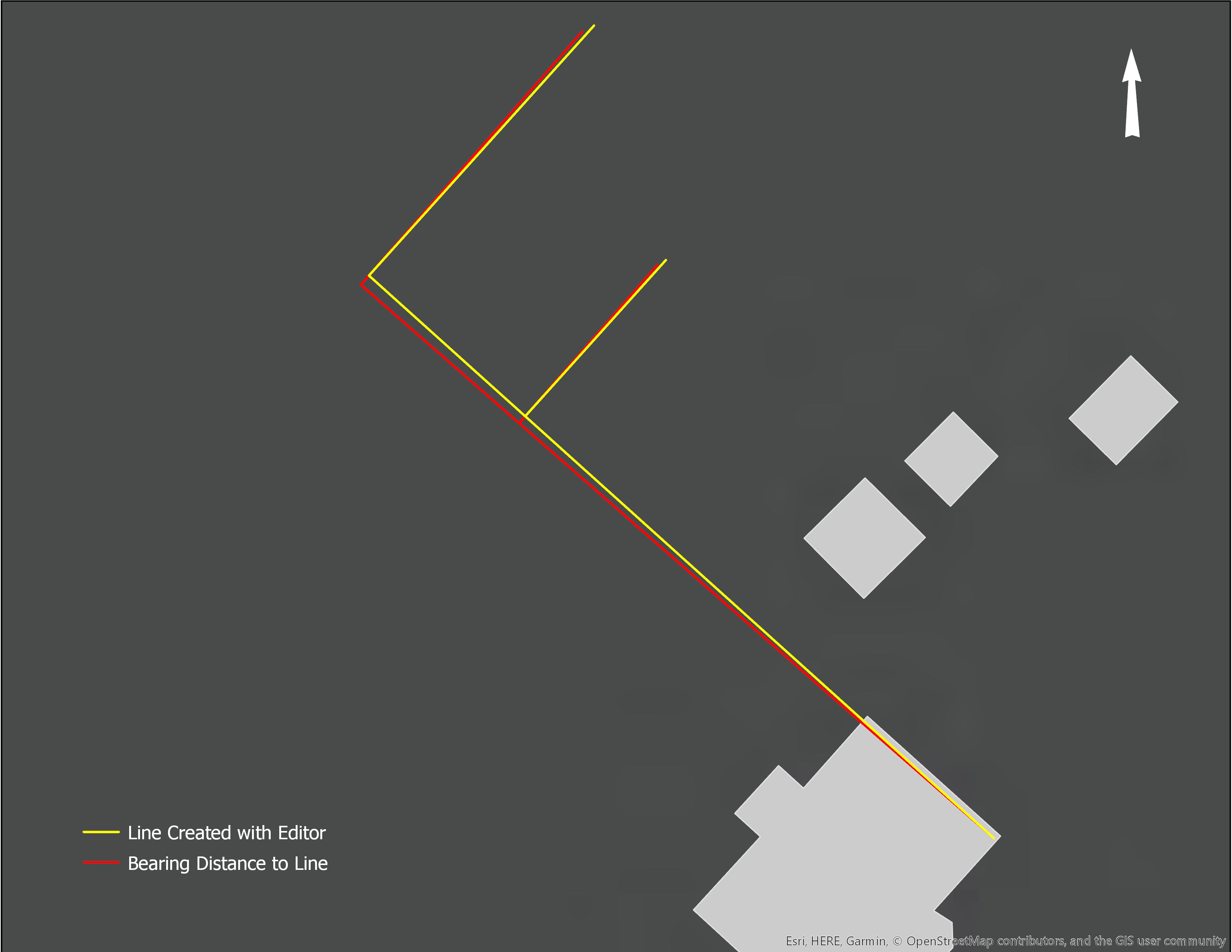

I created a model to plot a line for specified distances along a specified azimuth, then plot another line from the end vertice of that line for a specified distance in a perpendicular direction, then generate a point from end point of the second line. I used the “Bearing Distance To Line” tool to pull from a table that lists degree values to four decimal points (for example, 132.2458, 45.3789, etc.). The model seems to run fine, but the orientation of the automatically generated line is different from a manually generated line using the distance/direction function, even though the inputs are exactly the same. I thought maybe the projections were different for the two feature classes, but they are the same as well. I cannot figure out why this is happening or which result is more accurate, and was hoping someone might be able to help.

Kathy and Dan, I did speak at length with ESRI technical support about this issue. I went through three different levels of support and at the end the tech support analyst said that both outputs were correct. The difference, according to tech support, is that the editor tool draws lines using "planar" geometry, while the bearing distance to line tool draws lines in a "geodesic" geometry. The tools cannot at this time draw lines in the same geometry, so they will appear different. Tech Support said they would submit a request to the programmers for an "enhancement" to address this problem, which would be incorporated in some future update to the program. I just downloaded ArcGIS Pro 2.2.3, and it doesn't appear that they have fixed the problem in that version yet. I personally think this is a fairly major discrepancy; maybe if you reach out to ESRI we can get some momentum on the issue?

Thank you, Dan. Sorry that I wasn't more clear. When I said "manual" I meant using edit to create a new line feature, right-clicking as it is being drawn, selecting the direction/distance function, and then inputting the bearing in the "Horizontal/NAz" field, and the distance in the "Distance/ftUS" field. I left the "Pitch/dd" set at it's default value of 0.

I did follow your suggestion and used the "Bearing Distance to Line" from the data management toolbox, and that line drew the same as the one derived from the model. I'm still trying to figure out why the "sketch" method is different and which one is more accurate. I assume from your suggestion that you think the one from the data management toolbox is more accurate; my concern was whether it was rounding the azimuth value (which has four decimal points) before applying it, while the "sketchy" method was not. Thanks.

Dan, I'm not sure what you meant when you suggested doing the "maths." However, I dropped all decimals, then again ran the "bearing distance to line" tool and compared the results with a line created using the editor. I drew "L-shaped" lines using the same input for both tools: Line 1 was an azimuth of 312 degrees for a distance of 150 ft followed by an azimuth of 42 degrees for 50 feet; Line 2 was on an azimuth of 312 degrees for a distance of 200 ft followed by an azimuth of 42 degrees for 80 feet. I used the same coordinate system (NAD 1983 StatePlane Virginia North FIPS 4501 Feet) for both feature classes, but the results were again different (see attached graphic), with a difference of 3.14 feet on the longest line and 2.31 feet on the shorter line. I did not use any decimals, so it can't be a rounding error. This is very frustrating to me because I don't know why they wouldn't be the same, nor do I know which output to trust. Different results using "Bearing Distance to Line" tool and lines created using the editor.

I would file a Tech Support issue since you should be able to use both methods.
If the dataframe and the output featureclasses are in the same coordinate systems, then you have ruled that out.
I would trust the tool but... who knows.
I am more concerned that the angles are slightly different from the same origin.  If the angle specification was identical and the coordinates systems were identical, then they should be the same.  The distance issue could be due to a datum difference or some other specification.  Just ship it off for testing with your data would be your best bet.
