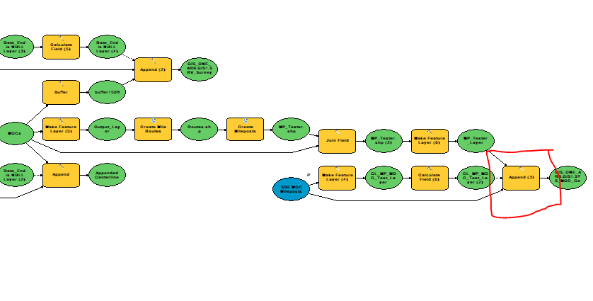

I’m having a doozy of a time figuring out a problem I am having with the model below. What the tool does is takes a layer of re-routes (lines) and makes survey corridors, centerlines, and mileposts based on the route name. The centerline and buffer part work perfectly. And the milepost section works just fine until I get to the final append shown in red below (apologies for the poor image quality). Follow me as I try to explain what is going on (or not going on, in this case).
When I open the append tool (prior to running the tool) I see MRL_RID and MRL_MEAS are not being mapped properly. Okay, I’ll add input…

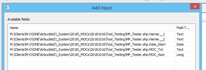

Hmmm, it looks like I can only add layers that were joined in the step before the append

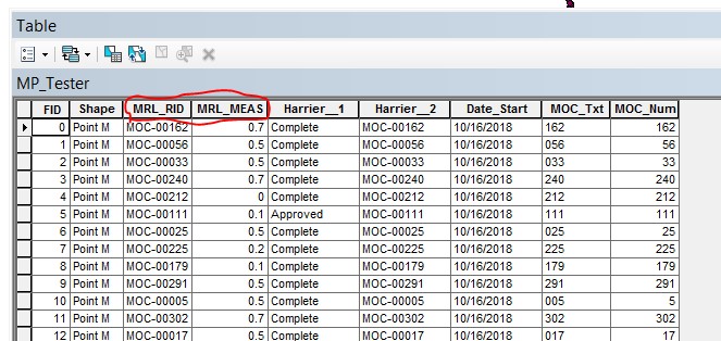

But when I look at the attribute table for the input feature I see MRL_RID and MRL_MEAS front and center.

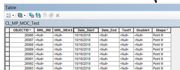

So I run the tool anyway which results in the table below. As you can see the MRL_RID and MRL_MEAS fields are blank (not good).

However, if I validate the model again or change any of the input features/parameters (which will be necessary) the properly mapped fields go away and I'm left with an append window like that shown in image 2. When I run the append tool by itself (not in the model) with the same Input and Target Datasets, everything matches just fine.
