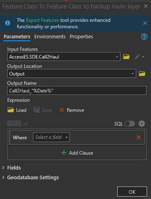

hello- I am trying to use the inline variable of either %Date% or %t% in an output name.
I am not using an iterator in this model, I simply want to be able to automat the output name to have the date included in the name.
I am getting the following messages (000354 if I use %date% and 000278 if I use %t%) , which could make sense if the model isn't actually recognizing the %.
  • ERROR 000354: The name contains invalid characters
  • ERROR 000278: Field mapping error: field type invalid for output field created_date and input field created_date
Do you have to be utilizing an iterator in your model in order to use the date inline variable?
Thanks in advance,
Vanessa

Iterators are not required in order to use inline variable.
%date% is not one of our supported system variables, so it doesn't work.
%t% should work and add time in the format of YYYYMMDDHHMMSS (inline variable documentation). This "ERROR 000278: Field mapping error: field type invalid for output field created_date and input field created_date" seems related to the Feature Class To Feature Class Tool. Could you please try use Export Features tool?

Thank you for the response. I must have mixed up seeing %data% and %date% when I was looking through the documentation yesterday!
I did a quick test using your suggestion. One test using Export Features with the %t%. And then, just for fun I decided to test it again with the FC to FC this time using %t%. I actually got both to work!
