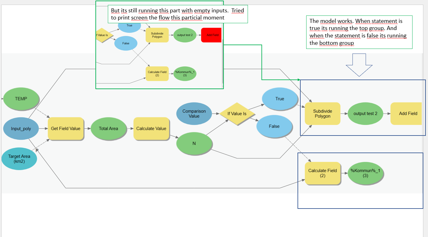

Hello, This script works. But I have some questions if this is as it should or if I can change it further.  I will try to explain with text and image.
The questions lies just after the If statement.  The model works. If the statement is True then it running the top group  (see the image below) . But If the statement is false then its running the bottom group.   - As I it should and it works as I wanted to.
But

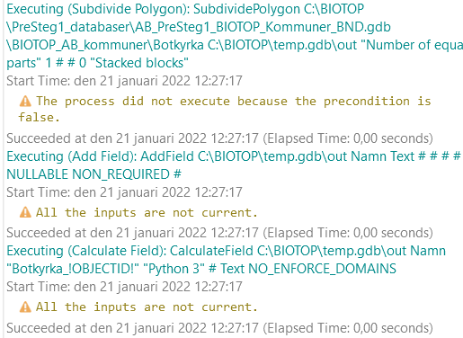

The situation: But even if the model is running as it should for the false statement. I still see that the model is try to run all the parts in the true statements but with empty values.  I have tried to make a print screen at that partial moment.
This is what I can read from the log
It tries to run even if it cannot och should not run. Is this a normal thing?
Here I tried to explain the question as an image.

I made a similar model that checks to see what FCs in a geodatabase have a GlobalID field, and which ones don't. Then the model adds a GlobalID fields to the FCs that don't.
If a precondition is false, and that tool in the model doesn't run, the messages usually reflect that.
So I see the same warning when my model runs through successfully.
From what I am reading you aren't having and problems with the results of your tool, correct?

From what I am reading you aren't having and problems with the results of your tool, correct?  Thats correct
"If a precondition is false, and that tool in the model doesn't run, the messages usually reflect that."
Ok, I think I can see your answer as a solution

Yes - for example, my model flashed that warning every time it found a feature class that already had a GlobalID (which was actually a good thing).
This behavior threw me off the first time I saw it too, but the results of the model were what I was looking for.
