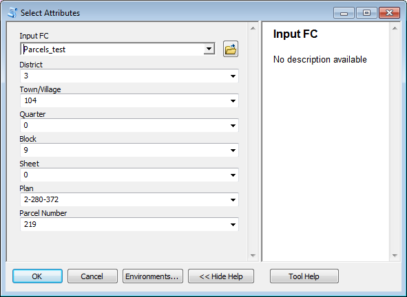

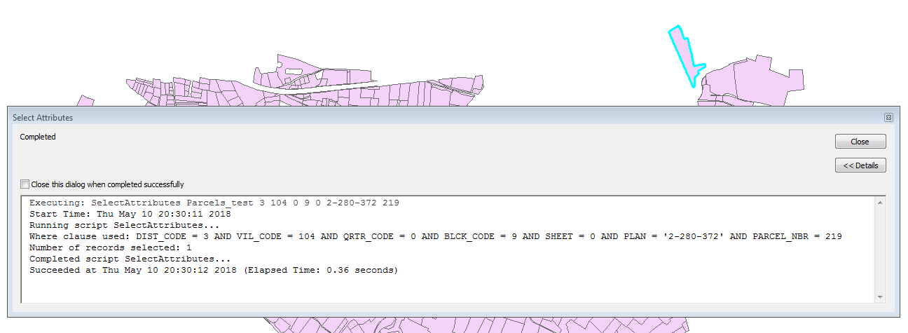

I've worked with the sample data that you have provided and have a script tool that might give you an idea for your project.  It is based on code in this thread: Conditional Drop Down Lists - Tool Validator.  If a feature is selected that has the required fields, it will allow the user to drill down to a parcel.  Currently the script just selects the parcel, but code can be added to zoom to it.
Most of the  work is done in the updateParameters module of the ToolValidator class:

The script I used for testing:
import arcpy
# to drill down to parcel number, use fields: DIST_CODE, VIL_CODE, QRTR_CODE, BLCK_CODE, SHEET, PLAN, PARCEL_NBR
# District, Town/Village, Quarter, Block, Sheet, Plan, and Parcel Number
inFC = arcpy.GetParameterAsText(0) # input feature class (Input, Data Type 'Feature Layer')
dist_code = arcpy.GetParameterAsText(1) # selected value of DIST_CODE field (Input, Data Type 'String')
vil_code = arcpy.GetParameterAsText(2) # selected value of VIL_CODE field (Input, Data Type 'String')
qrtr_code = arcpy.GetParameterAsText(3) # selected value of QRTR_CODE field (Input, Data Type 'String')

And a couple of screen shots.
Tool Photo
Screen shot
I've attached the code and toolbox.  You may need to edit the location of the script in the toolbox.  I've also included a debug version of the ToolValidator code should you wish examine it.
I'm not sure how a join would affect the tool as the field names sometimes get appended with the table name.

Mr Burton hello again. I tried your script and i incorporated teo models of mine.
Though it does work very nice when my data are a small amount of the original, when i use the SDE feature class where theere are around 1,5 million parcels then things get very difficult. I mean it takes a lot of time to show the values per field thus making it inconvinient to  use.
Any ideas how to improve the speed of the script?
Thank you for you time and efforts
