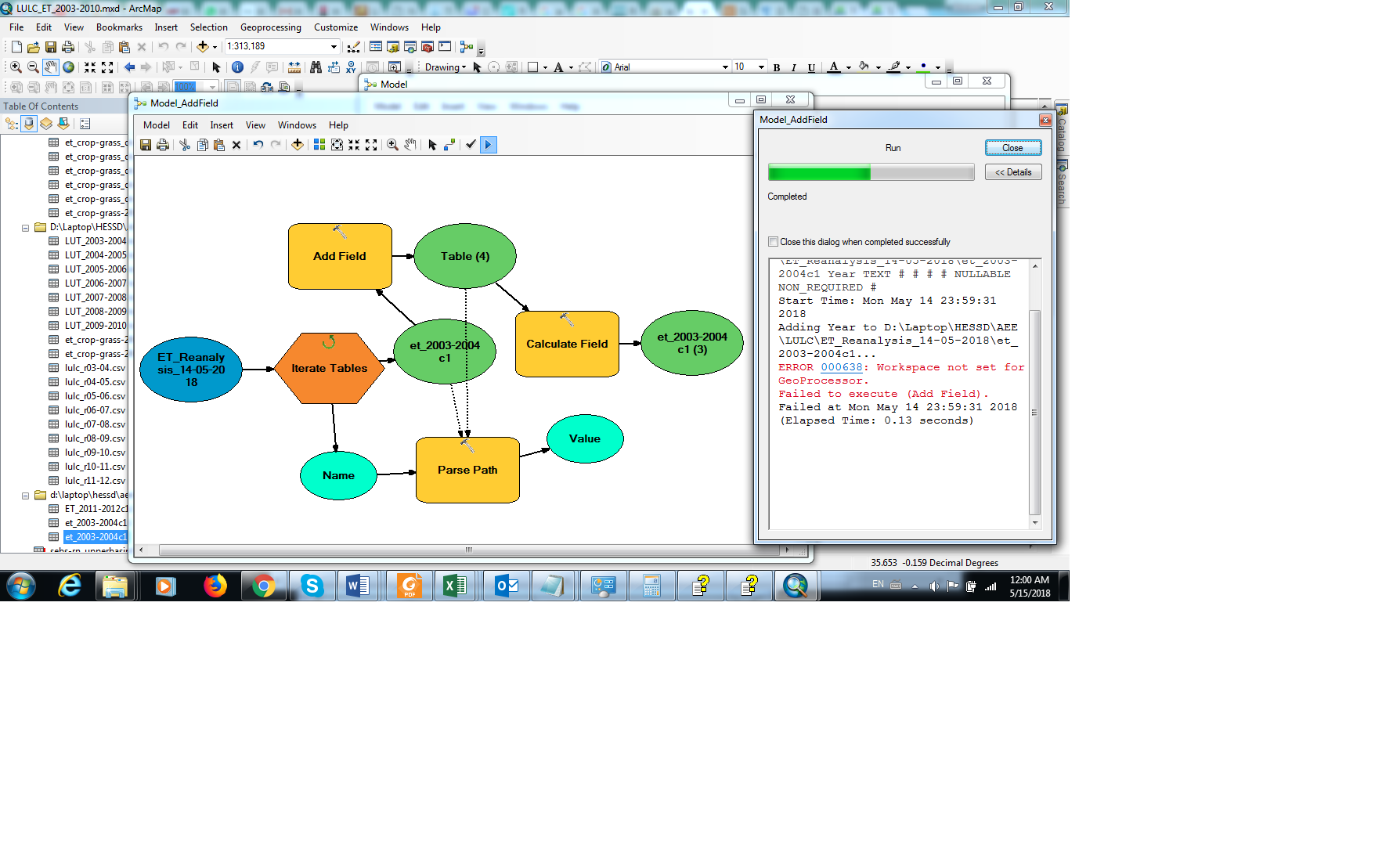

I have created a new field name to hold the filename of each table am iterating. I have used the parse path to collect the filename but and preconditioned the the parsing so that the field can be added first before the filename is populated in the new created field. When I run the model I an error that workspace not set for geoprocessor. Any help please?

Check this out :  000638: Workspace not set for GeoProcessor.—Help | ArcGIS Desktop
And this: https://community.esri.com/thread/48342
I can't quite get through your models logic, but make sure you are accessing a fgdb and not a feature class.  A workspace 'holds' the feature or table, so a workspace can be a directory (folder) that has a shapefile or dbf table.

I managed to overcome the problem and it works fine. The new problem I have now is how to select part(s) of the file names to be populated in to the new created field. As it is the whole file name is written but I just would like parts of the filename.

Am actually dealing with Tables. The fieldname is a string e.g. et_2003-2004c12 where the last two digits are indicates month of december. 2003-2004 represents the years which I also want to extract out into a separate field. I am a dummy with scripting in python let alone programming strings.

You really don't need the Parse Path step -- Name is already parsed, Name is the name of the table without any file extension. You can simply use Name in your Calculate Field expression -- that is: "%Name%".
VincentOgodo
This did not work. It created the field name but failed to populate the names. It resulted in empty records.
