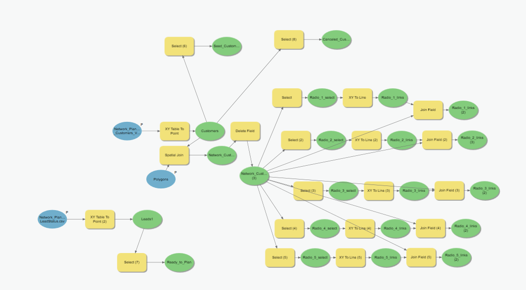

The model takes a CSV, creates points (customers) then draws a line from point to point according to the matching xy in each customer. It also creates another point file with another CSV file. Heres what it looks like:

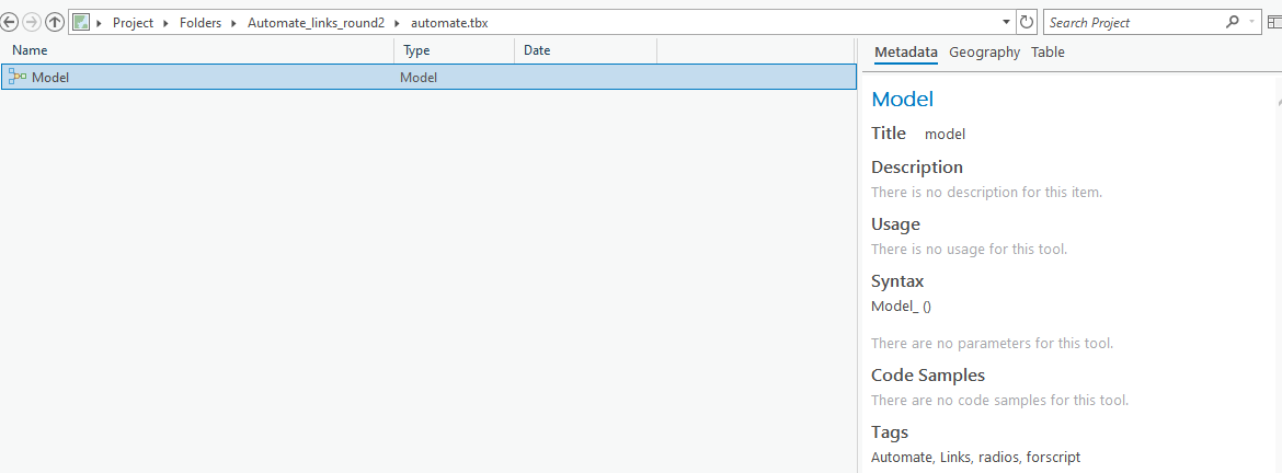

And here is the metadata for the tool:

Ok.. makes more sense now.  You might want to provide the 'alias' for the toolbox.
If your model is named "Model" and your toolbox is named "Automate"
you should be able to...
arcpy.ImportToolbox(r"C:/Users/Planner1/Documents/ArcGIS/Projects/Automate_links_round2/Automate.tbx, 'autostuff'"
then
arcpy.Model_autostuff or arcpy.autostuff.Model

Ohh, sorry Dan. automate is the toolbox and Model() is the model name. I am going off of what ESRI has on their site.
Schedule a model—ArcGIS Pro | ArcGIS Desktop
import arcpy
arcpy.ImportToolbox(r"C:\path\myToolbox.tbx", "tbxAlias")
arcpy.myModel_tbxAlias(r"c:\pathToInput\inputFolder", r"C:\pathToGdb\output.gdb")
