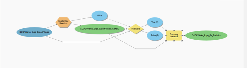

The model I made to try and do this does not work because I am probably not using the right tools or using them in the right order...
And here's a code snippet I tried to use from another similar post and I just changed the variables to match my data, but it did not work either.

I know how to make buffers do simple calculations but when attempting multiple tools that are dependent on each other, I get confused. I am fairly new to model builder and have little experience with coding so I do not know where to start, so any guidance will be helpful!
