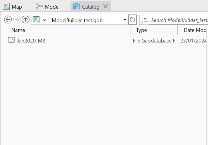

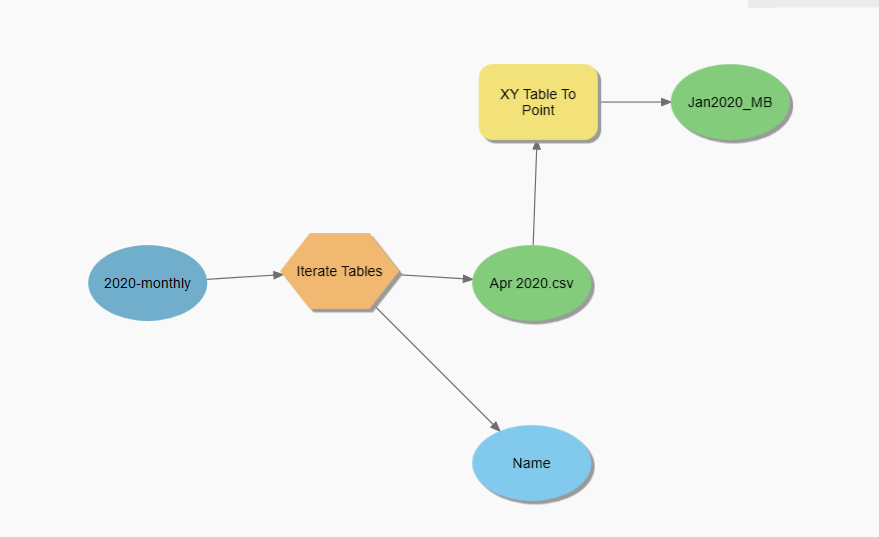

I then need to display all of these tables as points, converting them into feature classes in the geodatabase on the way. For the sake of organization and smooth workflow, I need the new feature classes to also keep the original Month_Year name. This is where I get stuck, as my ModelBuilder just produces one table/feature class and that’s it. What am I doing wrong?

Use Inline variable substitution:
https://pro.arcgis.com/en/pro-app/3.1/help/analysis/geoprocessing/modelbuilder/inline-variable-subst...
Make the GDB table name something like %Name%_MB
Then you'll get January_2020_MB, February_2020_MB tables out.

Two notes about inline variable substitution to generate output names:
If you need to get more fancy, for example, change special characters, add a filename extension, or specify a full path to put the output in a specific location, the way to do this is using Python string expressions in the Calculate Value tool. If it really gets complicated you can write a python function in that tool.
If you do this in a loop, it's good practice to use precondition, connecting the Calculate Value tool to the tool that writes output using the calculated path -- to ensure the pathnames get calculated before you use them within the process chain.
Example Calculate Value Python expression, with a fix in case the Name has an embedded space, and a .dbf extension for writing in dbase format to a folder.
r"%Out Folder%\%Name%.dbf".replace(" ","_")
