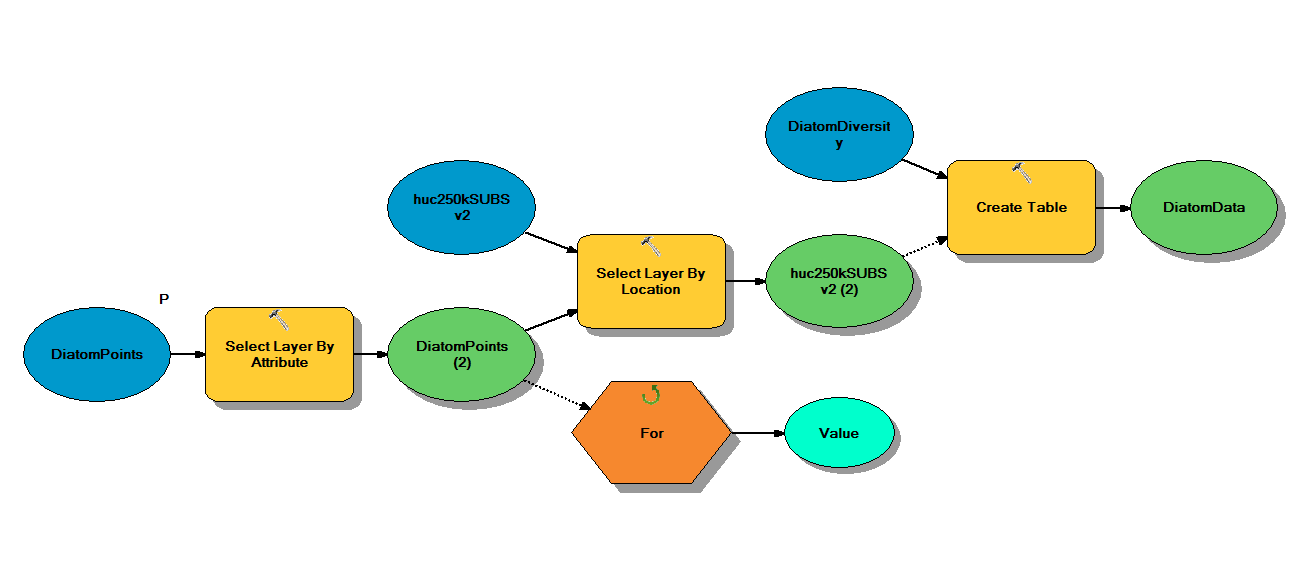

I am trying to automate a process to select polygons by location based on a different shapefile. This is the model I have built:
This model seems to be running in an infinite loop. What I am trying to do instead is to have it run through each of my 48,000+ data points from "DiatomsPoints" and select the polygon from "huc250kSUBSv2" for each point. Then, I would like the information to be collated into a table which shows the data from "DiatomsPoints" and the corresponding polygon from "huc250kSUBSv2". Is there a simple way to do this with model builder? I also have the Python code below, but I don't know how to code in Python (yet), so I'm not sure where I need to make changes, or even what changes to make. Thanks for your help!

Hi Christine,
You can accomplish this using the Spatial Join tool w/o the need for a model or script.
StevenGraf1
I see you are trying to do this in Model Builder but a tool is already developed for this call Spatial Join.  You can join 2 feature classes based on a spatial relationship.
ArcGIS Help 10.1
Hope this helps.
ChristineButterfield
Deactivated User
Thank you both for your help! That worked perfectly
