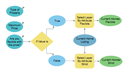

Could someone show me how to configure the Model Builder logical tool "If Value Is"?
I am trying to use it in exactly the same way as shown in the documentation with no luck.  My model has a Boolean parameter, just as the example below, which when checked at the start should produce a "true", unchecked a "false".  I can't figure out the settings for the tool itself to evaluate a true/false, yes/no question.  What would the settings be to make the model from the documentation, shown below, function?

In the model below "Is this it?" is a Boolean variable created with the Variable button from the ribbon, then connected to If Value Is, selecting the parameter Input value.
I then connected True and False outputs as precondition to further processing depending on whether "Is this it?" was set to true (checked) or false (unchecked).

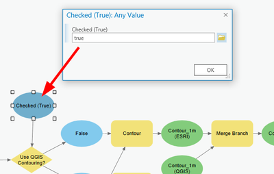

StephenM
Try putting true in the "Values" field. Note that it will create an Any Value variable pointing to the If Value Is tool, so it'll look a little different from the diagram.
