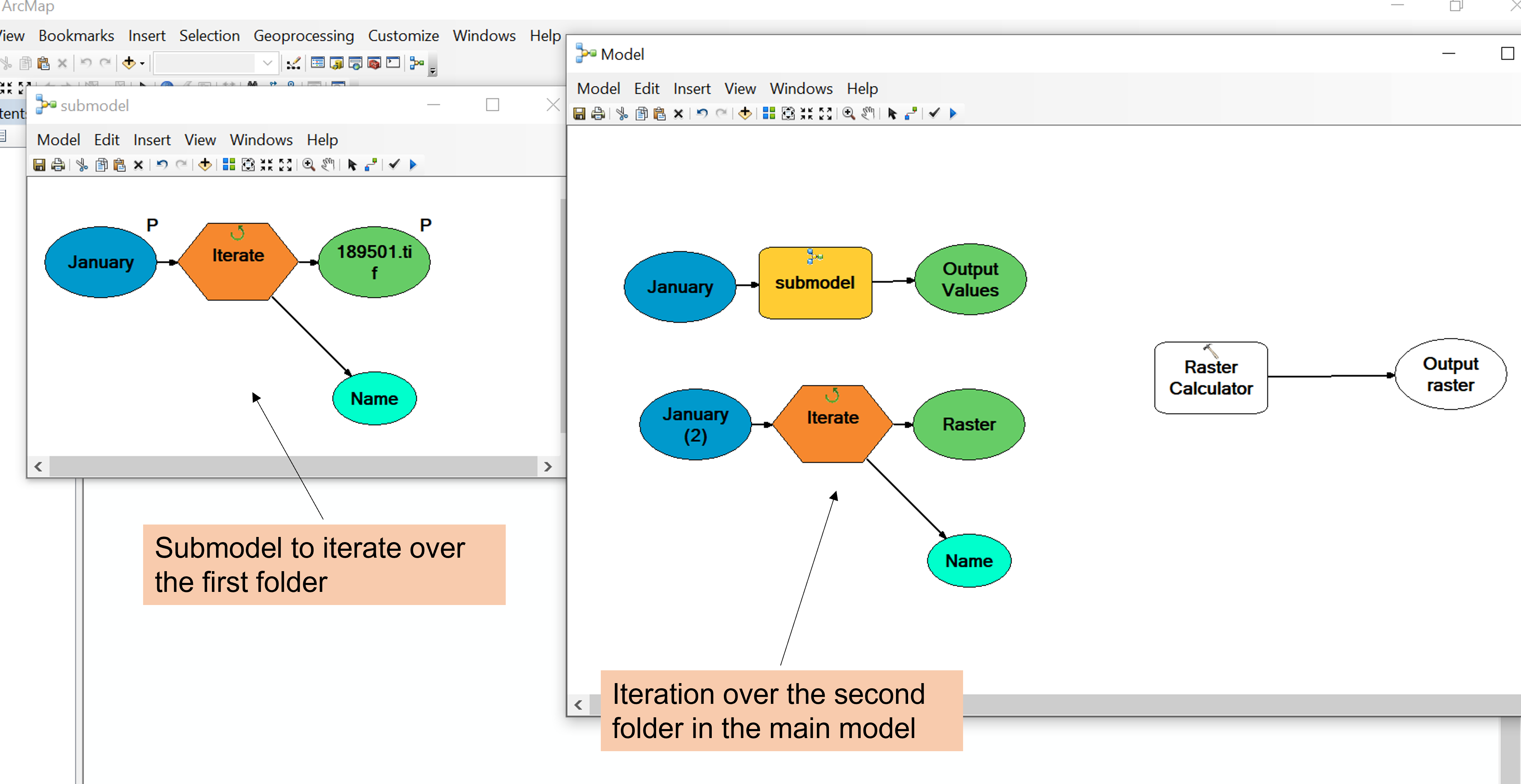

I have tried following this idea: idea: https://help.arcgis.com/en/arcgisdesktop/10.0/help/index.html#/Integrating_a_model_within_a_model/00...
with the result of the image below. I cannot connect the output of the submodel to the raster calculator of the main model.
Any idea in how to do it?

It sounds like you don't need nested models. Iterate over the first folder, this will yield the path to the first raster as users\folder1\raster1.tif for example.
Then then use the Name variable (which on that iteration will contain the text string "raster1.tif") to generate the path for the second by specifying it as users\folder2\%Name%.
Hope that helps you out!

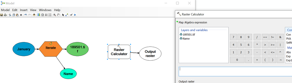

Thank you!but I am not sure how to implement it. Could you provide me with some visual example? How can I put the name as variable and after use to generate the path for the second folder?
I have attached an image about how looks the first iteration, and what I can see in the raster calculator
Could you give some advice in how to do it?

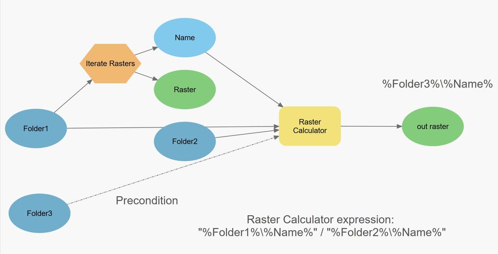

Maybe this will help.
SAV
Thank you for your help!
I could do it!
