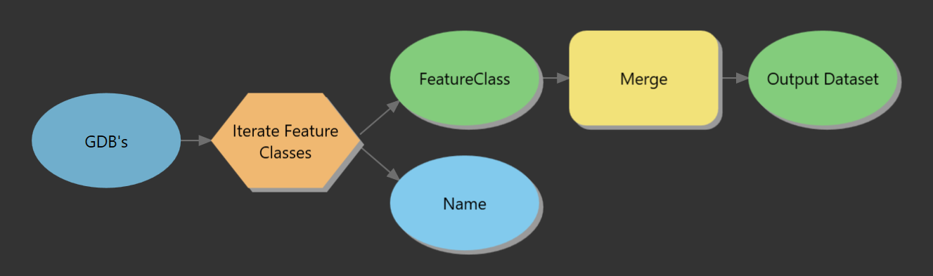

Iteration feature class merge and only getting that last file in the new output.
1295
11-08-2023 04:03 PM
Labels (2)
AndrewBivins
I am trying to pull the point feature from 12 different geodatabases and then merge them all into a new point file containing all the data.  When I run the process it returns the data from the last GDB file in the output dataset but does not include the other 11.  I am sure I am missing something simple.  I would appreciate any help.  Thank youScreenshot 2023-11-08 174204.pngScreenshot 2023-11-08 174204.png
any help.

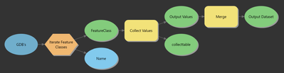

I believe I figured out how to make it work. Using the Collect Value tool did the trick.  I am a total hack at AGP so I am not going to explain how it works.  This post: https://community.esri.com/t5/modelbuilder-questions/merge-all-iteration-output-to-single-output-in/.... got me on track.
Below is my updated tool.
AndrewBivins
