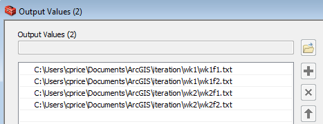

First, I created a model that iterates files for a workspace (get files)
iterate files model
This model is then embedded in a second model that iterates workspaces
(Side note, since Iterate Files requires a folder, I had to use the Calculate Value tool to convert the data type from workspace to folder here. You won't need that for rasters, because you can Iterate Rasters on a all kinds of workspaces, not just folders.)
model that iterates workspaces with iterate files nested inside
After this model runs Output Values (2) contains all the files:
file list
I believe in your case, you would set up the first model to use Iterate Rasters, and in the second model you could put your Mosaic To New Raster tool where I put Collect Values. If that input will not validate into Mosaic To New Raster, the workaround is to hide the tool inside a function inside Calculate Value. (Set the element Output Values as a precondition to this Calculate Value tool to make sure the input is ready to go when you run it.)

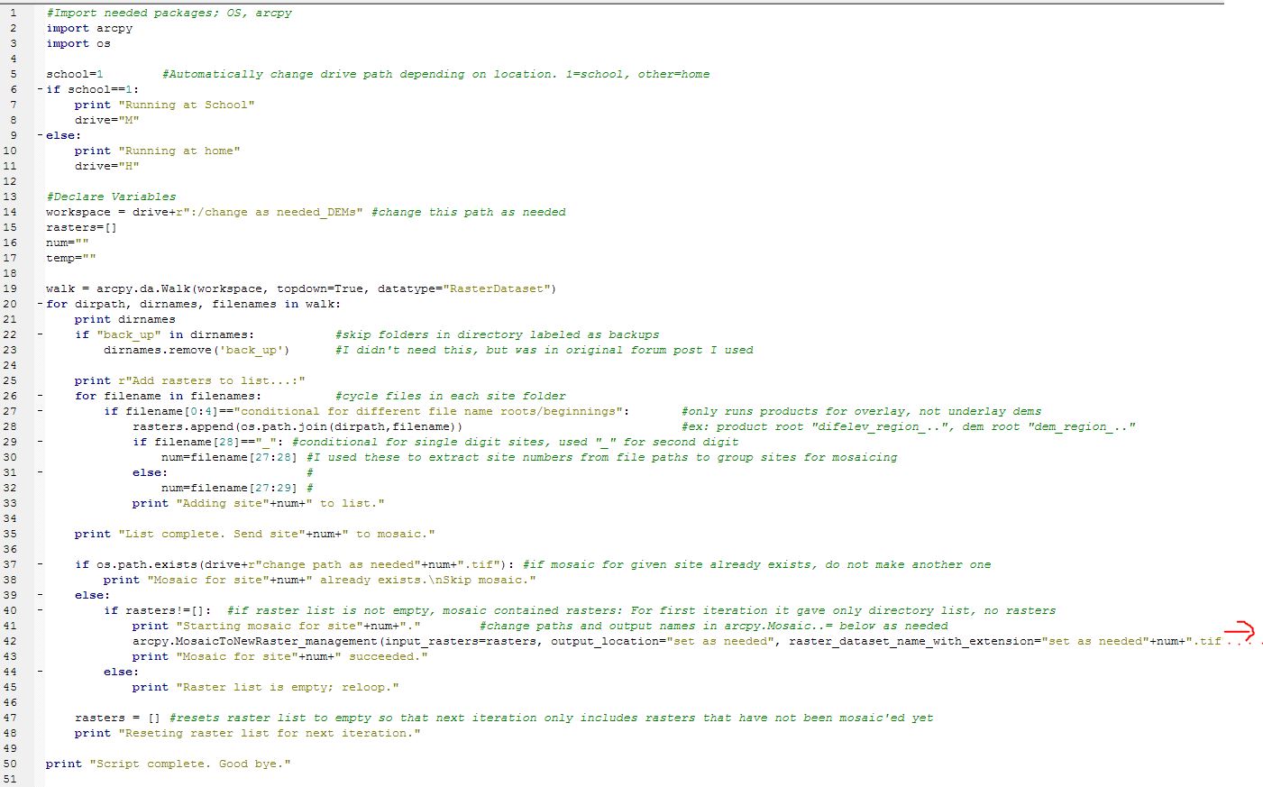

I had given up on trying to do it in model builder and did the Python for Everyone tutorial to get a grasp of it. Then using forums I was able to piece together a code that worked. It was perhaps more complicated than it needed to be trying to get conditionals to work depending on the name of files as I have two sets for each site; the normal dem, and a processed dem to overlay and show depth of holes (essentially wells in the study areas).
Model builder was great for processing the dem's into the overlays I needed. But for mosaicing together, since I had so many conditionals I wanted to impose it was easier to mosaic in arcpy with if statements (which in plotting this out I had several more and realized it was inefficient so I condensed it by the time I made this image). Apologies for the amateur code; I'm still very new to arcpy and python and haven't done any other coding for over six years.
Output looked kind of like this::
Adding rasters to list:
site1_tile1
site1_tile2
site1_tile3
List done; mosaicing tiles from list.
Reset list to empty and start new site (it was important to reset the list "rasters=[]" at the bottom of the code each time otherwise it would have just added site 2 to the end of site 1 list and mosaiced both sites together).
site2_tile1
site2_tile2>>>>>>
To test it I ran the entire process as print " " statements as above and left the mosaic tool in comment (#arcpy.mapping....) so it wouldn't take as long to test. Once the raster lists contained only raster tiles from a single site, and reset properly only including the next site,  I ran it through with mosaic uncommented.
I realized I deleted the tile sets after the mosaic finished to save hard drive space (as I have several redundant backups of them elsewhere) so I can't run it again and show the exact results.
Apologies if the pathnames are confusing. I have to get permission to publish anything with the actual dems and to avoid any issues I altered the pathnames that included them just incase.
And, now that those are done I'm trying to figure out how to use ArcPy to add layers to an mdx, set them into layer groups, and apply standard symbologies from an IDE; will probably be making a separate post on that soon as I'm having dificulty with it.
Thanks for all your help Curtis!
