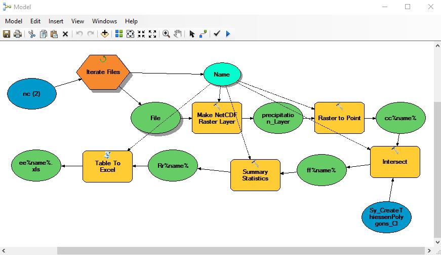

I have a folder with many raster files in .nc format. I want to build a model to do some proccessing on each raster and finally export an excel file for each raster with the same name. The model screen shot is
The model

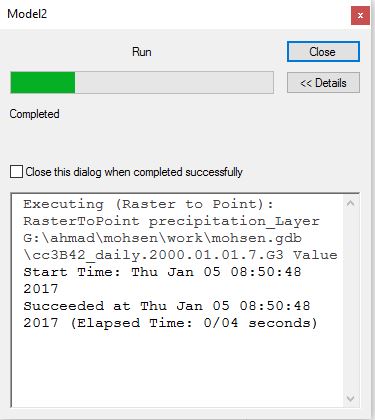

when I run the model its stopping with no result as picture shows:
Result
but the model work fine for one raster file.
Is something wrong with iterator files? and how can I fix it?

Do .nc files appear as datasets in Catalog? if so, then they may be being skipped Iterate Files—Help | ArcGIS Desktop I think you have to use the iterator on Reading netCDF data using geoprocessing tools—Help | ArcGIS Desktop rather than on the files directly

No, the .nc files does not appear in ArcCatalog. As you see I already imported the netCDF geoprocessing tool (make netCDF raster layer) in the model. I'm quite not sure about what to do. Can you explain how to fix it?

I highly recommend getting rid of the iterator in the model and getting it work for one dataset. Then add try adding the iterator once you have it working.

You may want to make the input file and name parameters put this model as a submodel of a another model that contains the iterator. This may avoid your validation problems.

I'm not sure what is your mean exactly!! Anyway I mean that if I remove the iterate file in the model and give it just one raster (nc format) file the whole process works good. Now I want to run this model for 5000 rasters. So I placed the 5000 rasters in one folder (folder name: "nc") and introduce it as a input. Now when I run the model the error comes up

the 'name' oval is connected to the export to excel oval.  you can't export a *nc file's name to excel.  look at the example of an iterator here Example of using an iterator in a model—Help | ArcGIS Desktop
