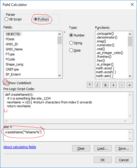

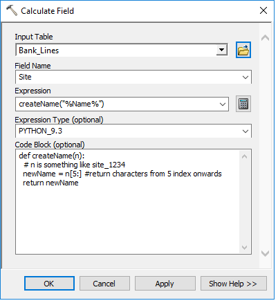

You achieve this by python string slicing.  So assuming all your input featureclass names are always the format of "Site_1234" then your field calculate tool need only be this:
Calculate Field and string slicing
To complete the expression click on the calculator button and complete as follows:
Building the expression
Note the parser type, code block the indentation in the script logic and your in-line variable is between double quotes.
