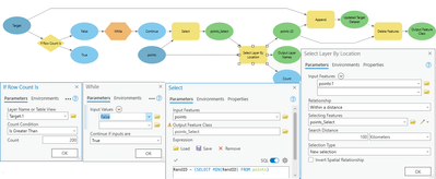

The selection part can go in between While and Append tool.
In the image below,
  • The If Row Count Is tool checks whether the "Target" dataset has over 200 rows.
  • If row count is greater than 200, the model stops running.
  • If row count is less than or equal to 200,
    Frist, select one row from "points" dataset which has the smallest RandID.
    Use this point as Selecting Features in the Select Layer By Location tool to select "points" within 100km.
    Selected points from the Select Layer By Location tool are appended to the "Target" dataset and removed from "points" dataset.
  • Then the model checks whether the "Target" dataset has over 200 rows. If not, repeat the above process.

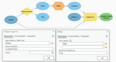

Hi @Alyssa_68 , hope the following workflow could help.
In the model below, I am using If Row Count Is tool to check if the input dataset "points" has over than 50 rows. The While tool output is connected to Append tool as Precondition link. This model will keep running and stop when the "points" dataset reaches over 50 rows.
  • When the "points" dataset has less than or equal to 50 rows, the If Row Count Is tool "false" output variable returns value "true". This matches with the While tool parameter setting. And it will continue running the Append tool.
  • If it has over 50 rows, the "False" variable returns value false. The Append tool will not run.

That answer is almost perfect! The only issue is I want to select a random point and then also have any points within a buffered radius also be selected and appended to the dataset. Then, ideally, deleted from the original point dataset so as the model continues iterating, it will select a new random point without any repeats. My initial dataset has a column of random numbers called RandID.
Thanks so much for your help!
In the image below,
