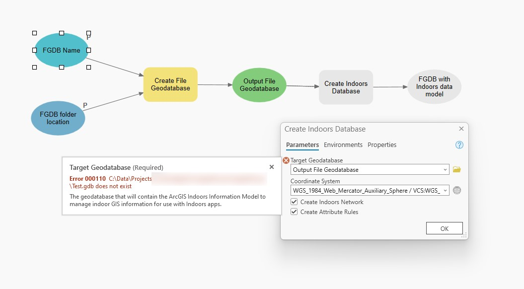

This is probably a really easy question but I'm just trying to get started with ModelBuilder and I'm completely stuck.
I'm trying to string two tools together to create a new file geodatabase, then use the newly created FGDB as the target geodatabase for the Create Indoors Database tool to populate it with the Indoors data model.  For some reason I can't seem to get the output of the Create File Geodatabase tool to be used as the input for the Create Indoors Database tool.  Does anyone know what I'm doing wrong here?  The error says that the target geodatabase (test.gdb) doesn't exist, but it will by the time the Create Indoors Database tool runs.
My model looks like this:
Any help would be greatly appreciated.

MappyIan
Hi @AyanPalit, thanks for the reply.
I have specified the name of the FGDB in the Create File Geodatabase tool (which is Test.gdb).
Selecting this Test.gdb in the Create Indoors Database tool is what shows the error I screen grabbed above saying:
'Error 000110 C:\Data\Projects\XXX\XXX\Test.gdb does not exist'
I know the target geodatabase (Test.gdb) doesn't exist, but it will by the time the Create Indoors Database tool runs.  I just want to use the database created from the Create File Geodatabase tool as the input to the Create Indoors Database tool.  What am I doing wrong?

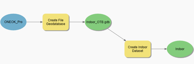

AyanPalit
I created the same in ArcGIS Pro 3.1 and ran it successfully. If your model matches as below, Validate and Run to test it out.

MappyIan
Thanks for the info @AyanPalit, I think I've realised what's happening.  I'm trying to use the Create Indoor Database tool, which doesn't validate and run; whereas you've used the Create Indoor Dataset tool, which does validate and run!  As noted by @SiqiLi, there seems to be a problem with the Create Indoor Database tool that prevents it from being used in this way.  Fingers crossed it'll be resolved soon.
Here's a model with both tools after it's been validated:
