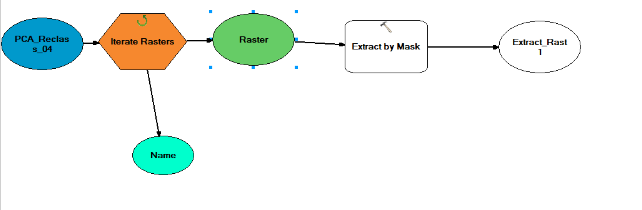

Hello I am new to new builder in ArcGIS desktop. As a first step I need to iterate rasters as input from a folder. Now I am using the tool, insert "Iterate rasters". But the the tool is showing "Raster" (green circle) instead of "Rasters" as there are more than one rasters in the folder. How can I fix this problem please?

you really need to read through the link previously provided Examples of inline model variable substitution—ArcMap | Documentation
%Name% is just the name of the dataset without the path.  The output should be C:\MyDatabase\%Name%.tif (or maybe just %Name%, try both - I don't use model builder)

Looks fine to me.  The 'Name' cyan bubble allows you to use %Name% in the end of the output path of the extract by mask options, the tool iterates through your workspace, running that model for each raster.
It's answered here https://community.esri.com/thread/198793-using-iterate-rasters , along with links for old - but still good - explanations.

Will the output from extract by mask return unique outputs for each input raster? Or do I have to insert another iterator for the output as well. Basically, what I am asking is that will the above model return n number of outputs for n number of input rasters?
Arthur_Morgan
I have an update Mr. Mike, The model does run, but the output is empty, please advise! I have attached a screenshot for further reference.
