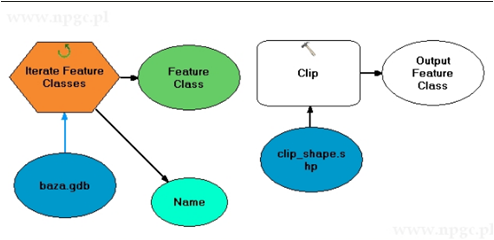

Hello,
I would like to clip 50 feature classes, which are stored in a personal geodatabase (baza.gdb), but I don't know how to add IterateFeatureClasses element to the model in ArcGIS 9.3.1
I have found a description how to do it in ArcGIS 10.3, but I don't know how to use it for ArcGIS 9.3.1.
Thank you for help,
Malgosia
Tags (1)
MalgorzataMendela
I have already known that there is no iterate features in ArcGIS 9.3. I have managed to solve my problem by defining variable for feature classes as a list of values.

MalgorzataMendela
curtvprice
MVP Alum
Iteration in 9.3 is a kind of tricky but it can be done by creating a list, as Malgorzata has done. Here's the help topic on that:
ArcGIS Desktop Help 9.3 - Iteration using Lists
10.x was a bit step forward for ModelBuilder.
