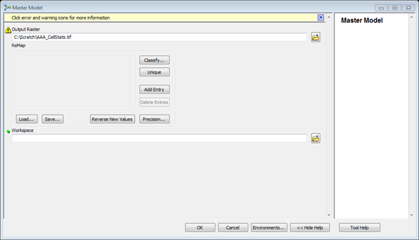

I use in a model a reclassification tool and I've set a remap as model parameter with some default values in a submodel. When I run this submodel separately everything goes well. The screen displays the table with default values which I can edit.
When I want to use this model as a submodel, I get an empty table which is impossible to edit.

When I open the tool I first get this:
Inital screen
 Then I select workspace:
Remap fills in as expected
As you can see the remap autocompletes and is freely editable. That's it! Nothing more. It sounds like a possible bug in version 10.0. ESRI don't seem to release patches for older versions, so you may need to upgrade (if you can) otherwise you'll just have to accept the limitations...
