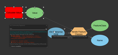

Could you expand on the calculate value tool? Here is what I have so far:

I would delete the append tool for now and use the Calculate Value tool with an expression like this to generate the output path:
output\enterprise\geodatabasepath\%Name%
Then run the iterator model and see if the output paths are correct. If they look good, add the Append back and connect that Calculate Value output  (set its data type to feature class in the CV tool first)  to the Append tool as an input.

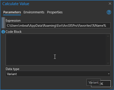

I'm sure I did something wrong, but I added the calculate value with the following parameters:

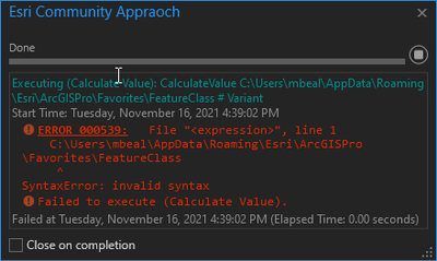

When I ran just that portion of the tool, I got the following Error message:
ERROR 000539: File "<expression>", line 1
C:\Users\mbeal\AppData\Roaming\Esri\ArcGISPro\Favorites\FeatureClass
SyntaxError: invalid syntax
Failed to execute (Calculate Value).

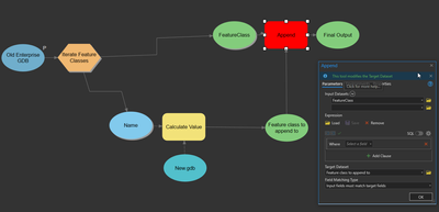

Here's my attempt at a workflow for you, which I set up using file geodatabases; should work the same with Enterprise if the paths are correct. The tricky part is that Calculate Value expression is   (a) a Python string expression and (b) the "r" is a raw string to protect the backslashes.
Run this thing and if the paths look right, add the Append tool to the model, connecting the two feature class variables (old and new) to the append tool.
The preconditions both document what you are doing and also make sure that the model variables used within the Calculate Value expression are up to date during each iteration.
Hope this helps you out!

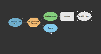

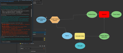

This is extremely helpful. I was able to get it to recreate the correct file path using this setup. When I add the append tool, however, I get a new series of errors:
ERROR 000622: Failed to execute (Append). Parameters are not valid.
ERROR 002948: The shape type of C:\Users\mbeal\AppData\Roaming\Esri\ArcGISPro\Favorites\OCGIS21_Vector - GISadmin.sde\OCGIS_2020.DBO.OconeeSoils_March20201 is not the same as that of previously entered datasets.
ERROR 000229: Cannot open C:\Users\mbeal\AppData\Roaming\Esri\ArcGISPro\Favorites\OCGIS21_Vector - GISadmin.sde\OCGIS_2020.DBO.OconeeSoils_March20201
The parameters that I have used for the Append tool are as follows:
Could it be the feature datasets in the EGDB throwing it off?

I would try to run the append command manually first. If the inputs paths are correct this is not a ModelBuilder problem.
Feature datasets could possibly mess with the path issue (requiring more complex logic for your Calculate Value expression) but you said the paths were correct.
Wondering about your "Favorites" paths - have the EGDBs been added to the project? I don't know if that matters or not.
MDB_GIS
Actually I was wrong. Upon looking closely, it is the feature dataset. It is not being included in the the file path. It is just using the database name and then the feature class. Completely skipping the feature dataset. Any ideas on how I could force it to include that as well?
curtvprice
MVP Alum
Try the Parse Path tool to manipulate the Feature Class pathname. Then include that variable (containing the feature class name) in your output path. You'll need to use it twice, first to pull out the full path to the feature dataset, a second run to strip out the feature dataset name.
