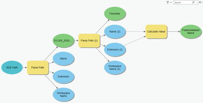

Ok. So I think that I am getting somewhere. Here is what I have now.

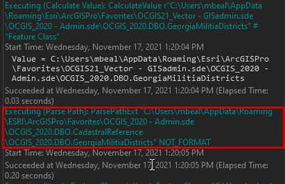

When I run that, the results window displays the following:
The part in red is the full path, which is correct. The feature dataset is OCGIS_2020.DBO.CadastralReference and the feature class is OCGIS_2020.DBO.GeorgiaMilitiaDistricts.
You mentioned that I would need to Parse the path twice. What would the input for the 2nd parse tool be? From there, what would I need to feed into the Append tool?

Example:
First parse path: input: C:\test.gdb\fds\fc output:c:\testgdb\fds
Second parse path input: C:\Testgdb\fds output: fds

The input SDE path above is
C:\Users\mbeal\AppData\Roaming\ESRI\ArcGISPro\Favorites\OCGIS_2020.DBO.CadastralReference\OCGIS_2020.DBO.GeorgiaMilitiaDistricts
The Calculate Value expression I'm using above is:
r"%name (2)%.%Extension (2)%"
which when executed becomes
After this you would use Calculate Value like before to assemble the pieces of your path, when it is correct you can use it for Append as you were before, except the path will be correct.
