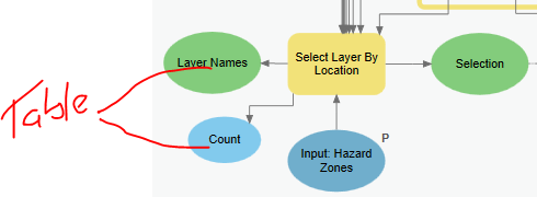

Hi,
In ArcGIS Pro 2.3.0 - Model Builder.
I am using the Select Layer By Location geoprocessing tool to make a selection through 9 different feature classes.
The main output is the selection itself, but the tool also generates a table with a list of the layer names for all input feature classes, and also a list for the count of select features within each one of these feature classes.
I would like to create a table output that would contain all the layer names listed in one field, and a second field for the count of selected features against each of these layer names.
Example of table to be generated:
Also, ideally this table could be saved in a gdb workspace.
Please let me know if someone has any suggestions!

These appear to be new output parameters for the SelectByLocation tool. A little research identified them to be lists where the values are separated by semicolons.  You can use the Calculate Value tool to write these out to a CSV file as shown below; the output layer names is a precondition to the Calculate Value tool.
The tool is set up as:
The Code block would be:
Description:
    This code will take the output lists created by the SelectByLocation tool in ArcGIS Pro 2.3 and write out the selection results to a CSV file
