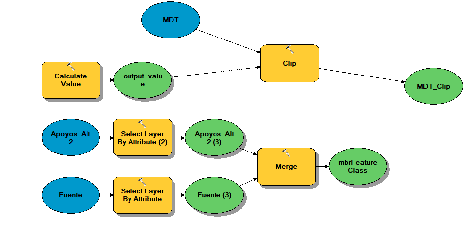

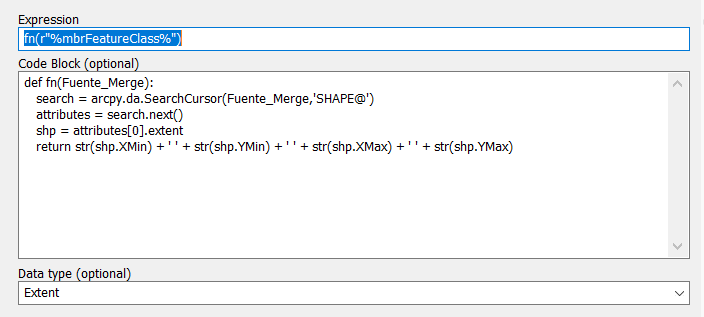

Hello.
I am creating a model that uses the extension of a feature to cut a raster.
I have managed to get the extension of my feature using Calculate value> Extent;
but I can't get that extension to be a parameter of the following tool
Any idea? Thanks!
AlbertoCañivano2
I answer myself with the solution.
As Environment had defined another extension at the tool level; so I never used the extension I passed it afterwards.
