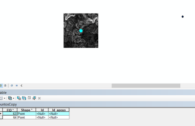

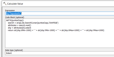

I am trying to get the extension using this post.
From a Feature Set that the user will populate (add a colon) and use as an extension to get a slope smaller in size.
AlbertoCaivano2_0-1678108766257.pngAlbertoCaivano2_0-1678108766257.pngAlbertoCaivano2_1-1678108801068.pngAlbertoCaivano2_1-1678108801068.png
The problem is that I only get the extension of the first point when I use the Feature set (append). And not the extension of the two generated points; so the cut extension of the slope raster is smaller than the one I am interested in.
Can you find the reason why? Thank you
curtvprice
MVP Alum
Your cursor is capturing the shape of the first point. I believe that if you want the extent of the union of both points, you want to get the extent from arcpy.Describe() on the feature set.
