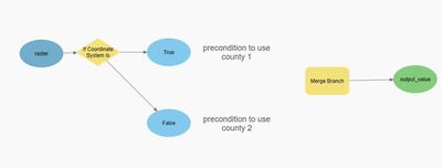

Here's an application of the conditional check Shitij is suggesting to use the county dataset you want based on the coordinate system of the input raster:
