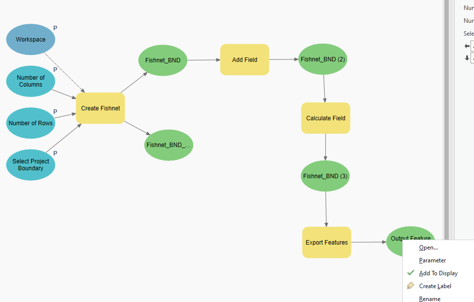

I am running across a small stumbling block and I wanted to see if anyone could assist me. I have built a model that creates a fishnet, added a name field, and then does a field calculate to get a name to be the same as the FID. It works great! However, even with the add to display clicked on it is not added it. I tried to also add the export feature tool at the end to see if that would force it but still not getting it on the map. Any help would be appreciated

Please can you check the field map that is set on the export tool? Check if that field is there in the list of fields that will be added, else add the field you want to the field map.

Maybe use the Copy Features tool instead of Export Features?
