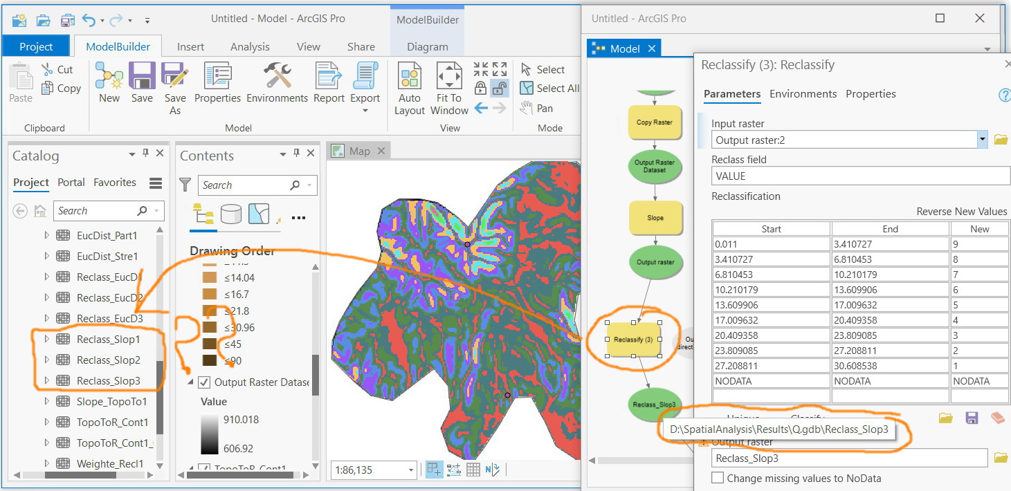

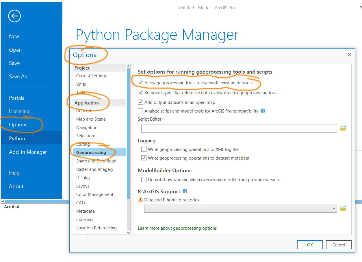

Despite the fact that “Allow geoprocessing tools to overwrite existing datasets” option is checked, outputs appear not be overwritten when working with model builder.
What could be the issue here?

I couldn’t find myself an option that allows overwriting except the one that appears in screenshots of my first post.

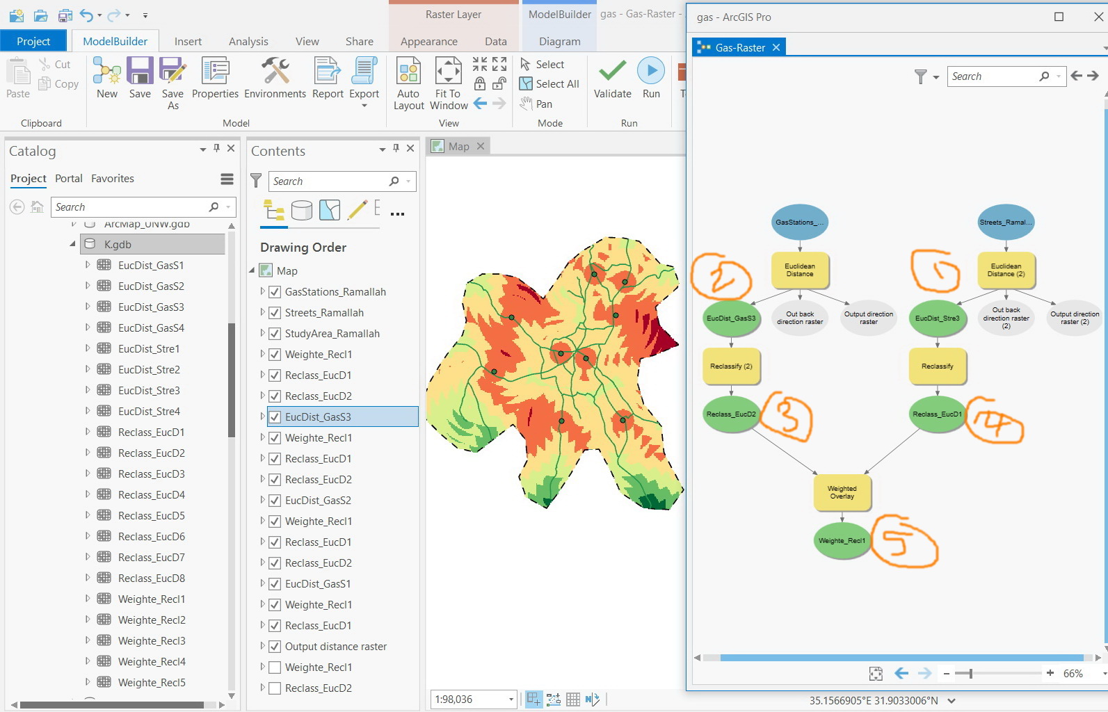

For example, if the cell size the in the “Euclidian Distance” is changed, then the outputs are not replaced, instead new raster are created!
Is there a way to overwrite such that the number of outputs are kept 5 for my model?
