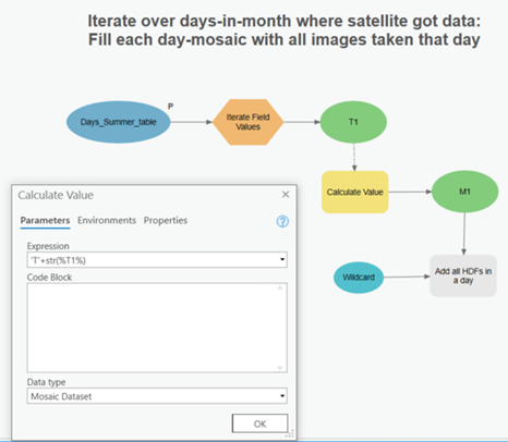

 First attempt: this model iterates over all dates that I've got saved in a table (Mosaic Datasets are created for each date in a separate model)
The submodel is greyed out, the Mosaic Dataset passed (as per the open window) shows with a red cross.

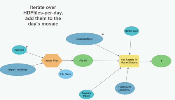

The submodel "Add all HDFs in a day":
When I run this, the submodel doesn't get run.

I believe you have the nesting backwards. The inner model (Iterate Field Values) should be embedded in the outer model (Iterate Fields). I also don't see you using the Collect Values tool to gather the list of data for each day. You need Collect Values in the "inner" model.
Examples of using Model Only tools in ModelBuilder—Help | ArcGIS Desktop
Hope this helps you out.

I tried many variation including ones with collect values. The issue always remained that in Model Builder "Add Rasters to Mosaic Dataset" did not accept that the mosaic dataset was being created as part of one of the models. "Add Rasters to Mosaic Dataset" kept insisting that because the mosaic dataset did not already exit, it would always be greyed out so never get called.

This is sometimes an issue with Model Builder - if the parameter validation isn't happy, you may be stuck.
To get around validation roadblocks you can use a Python script (as you did) or run the tool using a Python function inside a Calculate Value tool, which bypasses the pre-run validation ModelBuilder does.
