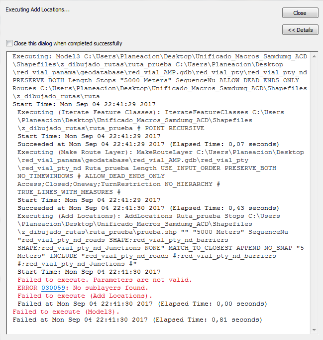

Right now I'm developing a tool that takes from a workspace a shapefile of poits (routes stops) and add location to a route Layer, after I select the solve route and export it as a shapefile to other folder, not a complex thing.
It seems to be ok, but It gives me back a error mesage when I try to run it:
it seems to be a trouble in add location tool, it doesn't recive the layer from iterate feature class, I run just that part in arc map, add locations ad it works fine, so I really don't know what is happening, any ideas will be really helpful.
thanks.

Have you read the linked error message?
030047: Not all network location fields have a field mapping or default value.—Help | ArcGIS Desktop
Add Locations—ArcGIS Pro | ArcGIS Desktop
From the tool reference:
If you specify the field mapping for any of the network location properties, you need to specify the field mappings for the remaining network location properties to avoid a tool execution error.

exploring the tool inside the model builder I found this
any ideas?
