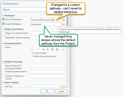

As discussed in this question post, I'd like to be able to clear or reset the Environment Settings for a Model so that it uses the default database/workspace of the user/project. Currently, once one of those Environment Settings have been modified, it seems to be impossible to reset it back, forcing the model to continue using a specified location. This has been problematic for me as the locations specified don't always work for all users on all devices (e.g. different permissions on a remote server compared to a users PC).
