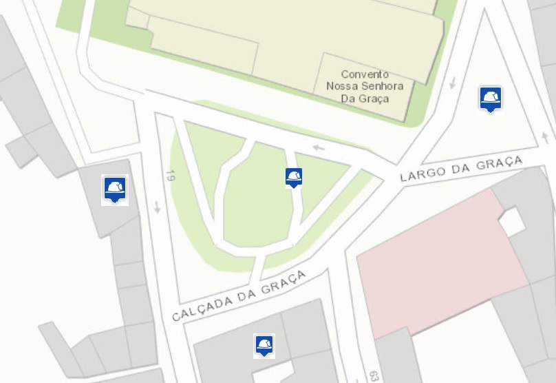

Also in version 10.1 the symbols are displayed without the white square:
Be aware that all layer beneath the points will be rasterized. For more information on that, please read the help topic on "About map printing", especially the part on "Printed map appears blocky or pixelated - Rasterization" in Troubleshooting map printing.
You can also define an equal color for the background and select that color as transparent color (not possible for PNG, but you can do this for GIF, BMP, etc).
This might be a little rough with the symbols you're using since they have a semi-transparent shade surrounding the picture.
