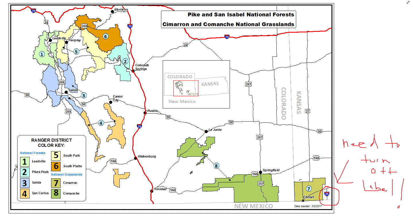

I am working on this Damn it Highways layer and I need to selected some labels for some of the highways. One of them I need to "turn it off" but it would not let me to.
I have this map that I am working on and is for to put on the webpage later.
That label I-25  I drew the red circle the lower right bottom of the map   in Southwestern Kansas I need that to turn off but leave the road on. It would not turn it off.
Why doesn't my SQL query not working ?

I take it that feature you want to remove the label from is "FID" = 321?

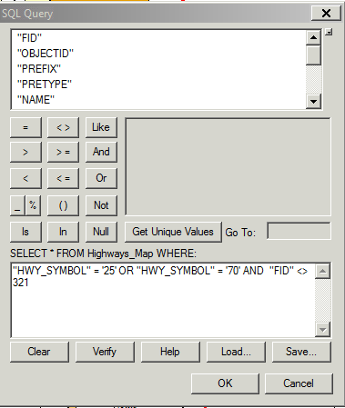

After I posted it here, I played it around  a little bit and decide to flipped the expression like this:
"FID" <> 321 AND "HWY_SYMBOL" = '25' OR "HWY_SYMBOL" = '70'
that worked ! That I-25 Label now disappear !

I suspect it's just a matter of how the SQL interprets the grouping of your terms, which is why you should always force your grouping with parentheses. I suspect in your original attempt ("HWY_SYMBOL" = '25' OR "HWY_SYMBOL" = '70' AND "FID" <> 321), it was interpreted as:
"HWY_SYMBOL" = '25' OR ("HWY_SYMBOL" = '70' AND "FID" <> 321)
Since FID=321 is HWY_SYMBOL='25', all labels will show.
I think you could change your original to the following:
("HWY_SYMBOL" = '25' OR "HWY_SYMBOL" = '70') AND "FID" <> 321
This will first filter the HWY_SYMBOL to either '25' or '70', and from those, remove FID=321.

I tried to put parentheses on the first expression before the OR and didn't work so  my expression wasn't right. So, that is why I move the FID <> 321 at the beginning of the expression and then insert the HWY_SYMBOL = 25 or HWY_SYMBOL = 70. after the AND.
