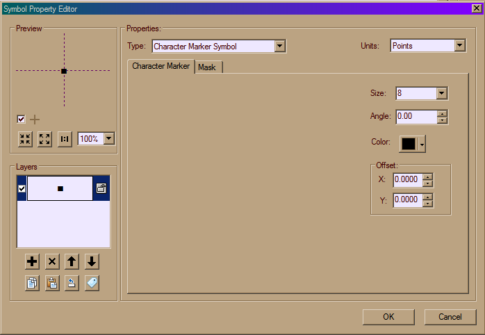

We just upgraded to ArcGIS 10 and whenever I try to change point feature symbology, Character Markers will not display, and I cannot edit point symbols beyond size, color, and masks of existing symbols. I've tried rolling back to 9.3 but no dice. Please advise.

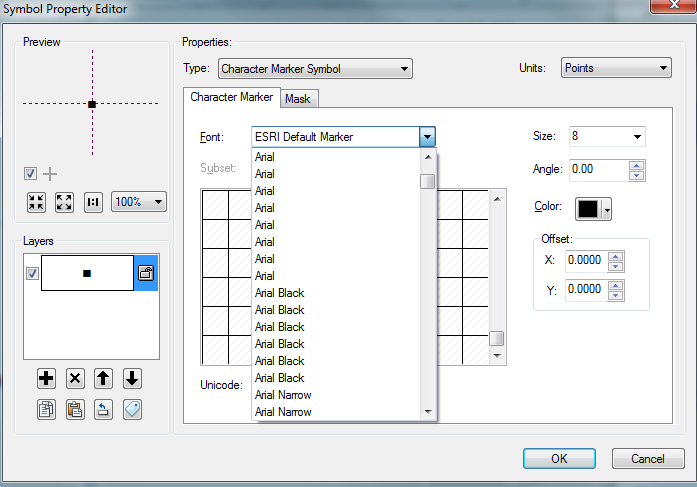

I also have this issue, the character marker editor slowly opens and then everything is blank (10.3.1.)
And if I click the font dropdown menu, all the values duplicate themselves.

I return to edit my own post, because the solution for me anyways seems to be that posted in this forum above from Bryan Kaplan in 2014, which indicates the problem to be related to a setting in ADI, specifically, Hydravision, Desktop Manager, and disabling the "Enable Dialog Repositioning."  Doing this made everything return to normal.  See arcgis 10.0 - Why are Character Marker Symbol Dialog not showing up in the Symbol Property Editor di...

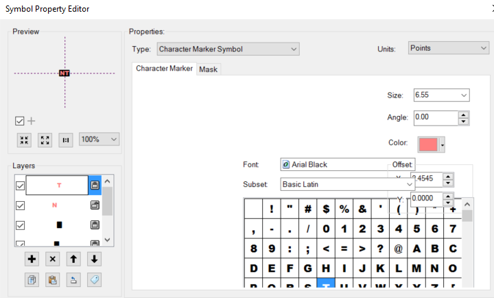

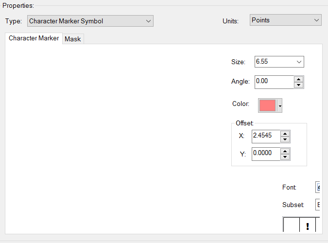

I have Windows 10 without a HydraVision graphics card controller, but I've struggled with this for years with various hardware setups.  I have found a cumbersome workaround, but it does work. Here you go:
You have to adjust the screen resolution.  So, to be able to see the character set, use the display options to ramp the screen resolution all the way down as far as it will go (in my case 800 x 600).  This shows most of the character set and you can scroll down to what you need:
BUT, you aren't able to access the "X-Y" controls when they sit behind the character set, so to do that, place the display back to the optimal resolution.  You can't change the characters anymore, but you can access the X and Y settings:
So just toggle between resolutions.  This is difficult, but it's better than nothing.  I hope this helps some of you.
