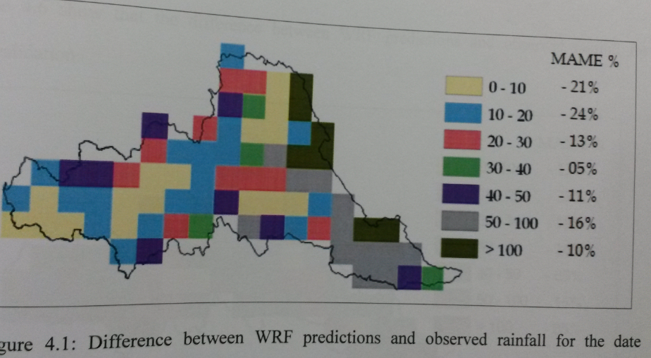

I have my Rainfall data on points as shown in the following diagram.
I want them to be show in 3km X 3km grids as shown the following diagram.
I also want the values in these grids as shown in the above, (ie - in regular interval like 0-10, 10-20 ) and the area percentage of these values.
Can you please say me what tool I have to use and how to use them.
Any help is highly appreciable.

DanPatterson_Retired
MVP Emeritus
if you have an advanced license, you can do a direct conversion specifying the cell size the same as your interpoint spacing using Point to Raster—Help | ArcGIS for Desktop
if not, you can use Create Fishnet—Help | ArcGIS for Desktop to create square polygons centered about your points, then spatially join the points to the polygon to bring your attributes over.
The classes and symbology, just use standard tools as covered in the help topics
The clipping is the same, but with the raster, you may want to mask out the exterior area to blend in with the background if you choose.
