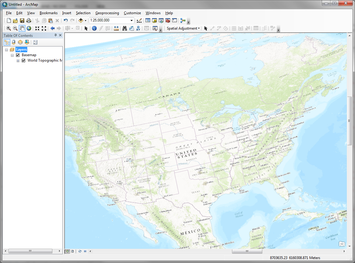

Also, would you mind sharing the extent of the original data? If you add the data to a new ArcMap and don't change the data frame's coordinate system, what are the extents as you check the edges of the data?
If I add the Esri topographic base map (EPSG:3857), and change the data frame's coordinate system to Hawaii Albers, the extents of the lower 48 are (very roughly!):
x min: 2950000 m
y min: 2060000
x max: 8400000
y max: 5000000
